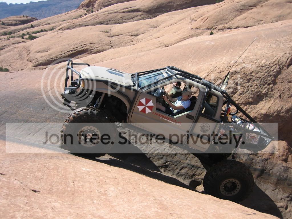

I picked up a pair of steering rockwells for a good price with plans to put in my S10 truggy but with a possible future move in the plans , and hard to say if will have a shop to work in once moved, trying to decide if it is really worth it. I currently have a GM 60 front with full chomoly shafts (spicer joints), solid knuckles, full hydro high steer, lockerer, etc and a 14ff rear lockers, disked, linked and 5.38 gears. I have broke a cromoly shaft and twisted another one up and a spicer u-joint along with breaking a 14ff shaft in the last 2 years since I built the Sonoma truggy. I have full spares for every shaft on the rig and spare driveshaft to front front/rear. Was planning on linking the front when I swapped in the rockwell but now thinking to sell the rocks and finish linking the front of this rig. It weighs 6100 pounds currently fully loaded ready to wheel with a 454, th400, doubler, and tons on 43 SXs.
My question is do you think it is really worth the work and money to swap to rockwells? Rear steer would be cool but really with cutting brakes currently I get around pretty good. The rocks still need steering, brakes, and a some little parts (about another $1000 to have them ready to put in). Already shaved them, welded gears, etc but would be on stock shafts and don't have any spare anything. Plus to fit them I plan on moving engine up and back a handful to get front diff to clear so there is pretty much a complete truck remodel in the books to do it. Maybe sell rocks, finish front link job, and put some quality joints in 60 and be content? Sounds like a drama noob post but what the hell...

Last year I broke a chromoly stub, twisted a chromoly inner, and broke a spicer 806 joint. Year before that I broke a 14ff shaft and stock inner shaft. IMO its not too bad. The weight difference on a stripped rock (no drum brakes but not counting steering and pinion brake0 is 155 lbs from my research so in reality probably 180-200 lbs heavier. To swap I need to at minimum raise engine/trans/cases 3-4" so I could have about 5-6" of uptravel with a rockwell. Otherwise I was thinking of moving the engine back 12" so I can get the front axle in front of engine and not make it stupid long wheelbase. There is a local with a ext cab s10 cab truck like mine on steering rocks and 49s with a 440 engine n the stock location and his front is in front of engine and his wheelbase is 145" which I was hoping to avoid. I know the swap and engine moving stuff can be done. Would have been alot easier to do it when first building the rig though and with the possibility of not having a shop to work in would make the stuff really difficult.

I am really leaning that way right now. Sell them, finish linking front and put some good joints in axles. Added it up and I have about $1700 into all the rockwell/rear steer stuff I had collected but have a buyer if I wanna sell.
