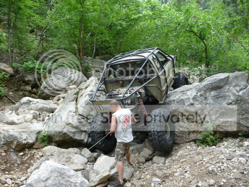

Can I ask when you broke the axles? Were you jammed up hard, rubbing on stuff?
all my recent front axle brakes have been in our clubs artificial rock course. Its easy to get bound up in it. Here is a pic of the course, don't have any shots of rig on it:
Where rear shaft broke:
