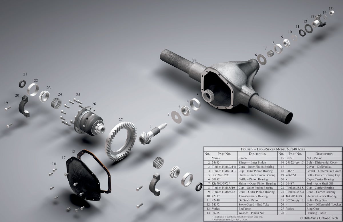

In this photo, item #6 pinion baffle, my axle didn't have one in it. Is this ok or should I get one? Or is it just needed in high pinion 60s?
