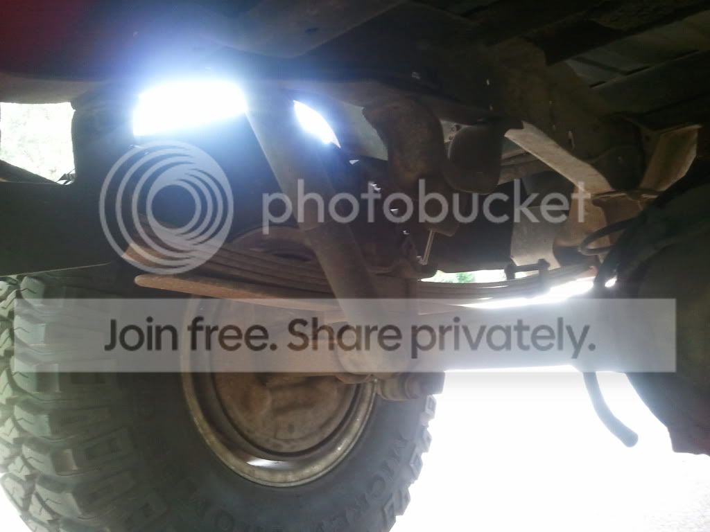

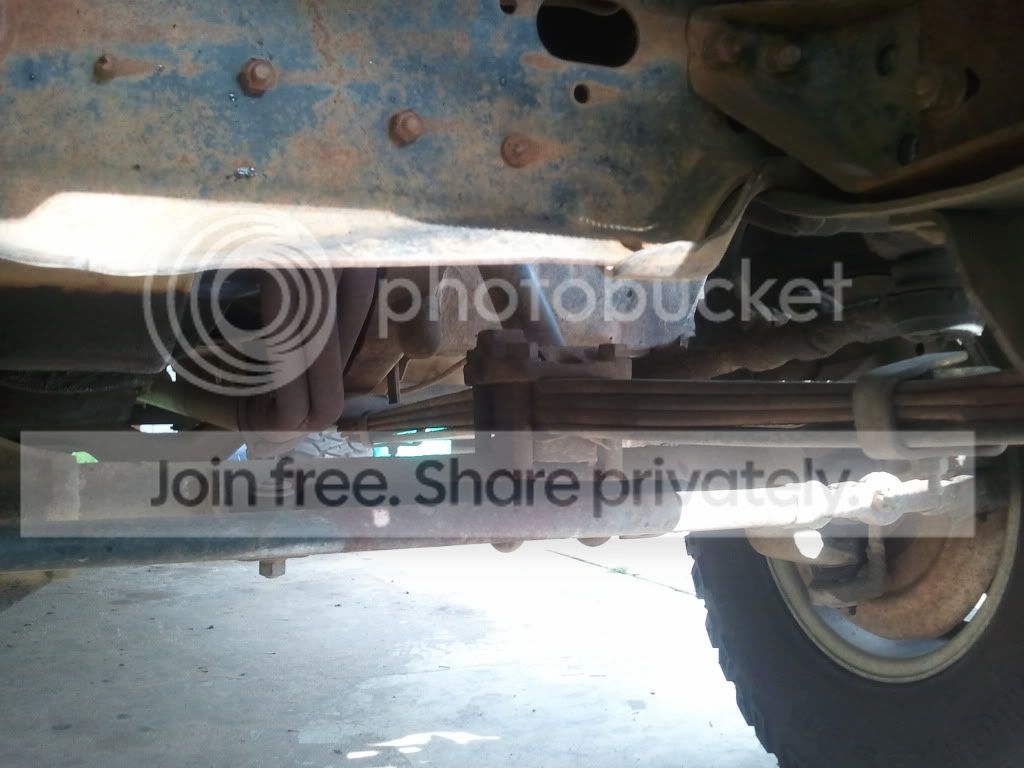

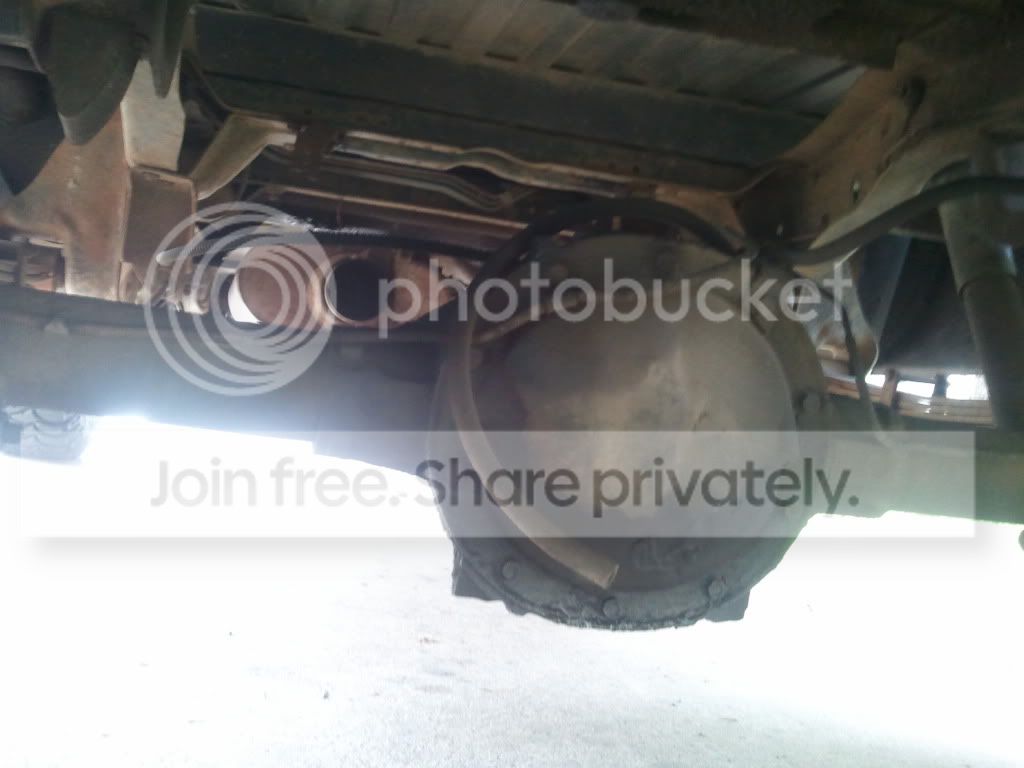

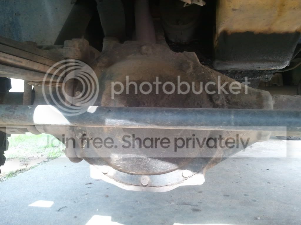

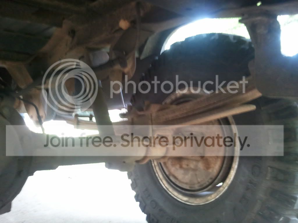

Ok even though we figured out I have disks lol, here are the pics my axles.
front axle obviously
pass front leaf
driver front leaf
rear axle...ignore vent and leaky covers on both axles...this weekend project
pass rear leaf
driver rear leaf.
Ok so what can you tell me about my leafs?
Front-is that an add a leaf or just a leaf from another pack? Also should they arch upward like that??
The stock front springs for these trucks are what's called negative arched. They arch upward instead of down like the rears.
Yours appear to have an add a leaf installed. On top of that they look sacked out. No real curve left to the springs just straight lines from axle to bushings. Not sure what your plans are for the truck but it looks like it could benefit from a set of 2" lift front springs, specifically Tuff Country EZ rides for best results.

I guess the front springs being toast would explain why the front rides so freekin stiff??
Add a leafs are typically never soft either. Looks like you are running 33" tires too. The 2" lift springs will be good for those. I wouldn't doubt if the truck sits level after just installing front springs. May not need blocks in the back at all, but wont know till it's all together.

Shackle flip in the rear is the way to go. And your rear springs look like they are in good shape. Aside from possible bushing replacement, but the springs themselves look good.
