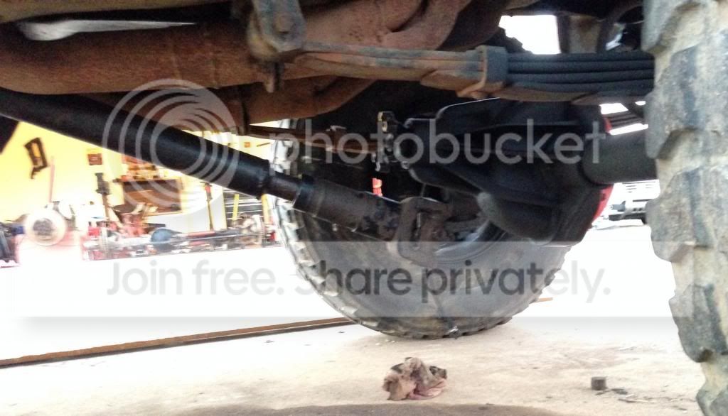

Ok here is the drive shaft still attached to the NP208.
I pulled the drive shaft and I will post detailed pictures of the stops on the cardan before and after as I go. $200 is a bit much to fork over when there is a possible free solution.
How I hadn't already broken it is beyond me. It had to be nearly maxed out on flat ground connected to the old 10 bolt. I twisted the crap out of it a few times
What do you have under the front?? It looks like a HP Ford with driver side drop and the the shaft looks to be a passenger side drop from the pictures. Or it this an optical illusion????

you should be fine grinding down the spots you have circled. There are also a couple up inside the H-yoke that can be ground down as well but you have to take it all apart.
I would grind what you have circle liberally and call it good. If you need more flex than that offers you need a new shaft but I don't see any reason why you would with stock length front springs and a hp front end.
You should be fine. I would be running the same drivetrain setup in my 92 with the drivers drop np241 and hp ford axle. I'm running 52" springs up front and 7-8" of lift with a stock 1990 k5 blazer front driveshaft and grinded CV stops.
