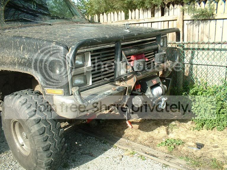

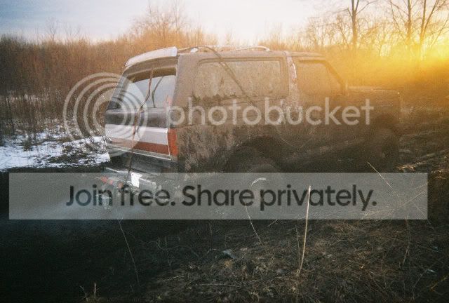

yeah thats what i got on my truck. not only is it cool when your not using it you can take it off and put it in the garage or go from front to back on your truck. i used it a few times when friend of mine went way back in fields and got stuck and instead of me going back there and getting my truck stuck too i would just bring the winch out there and hook it up in the back hitch and pull him out. great investment. that front hitch can take a beating too
heres a few pictures of my set up.
when i first got it on my old suburban
heres a picture of just the hitch on my current truck
and heres the bronco i threw it on the back of to pull him out of some mud.
awesome man, im definitely getting it then. thanks for the pics and input!...now if i could only afford a 12k winch:thinking::D

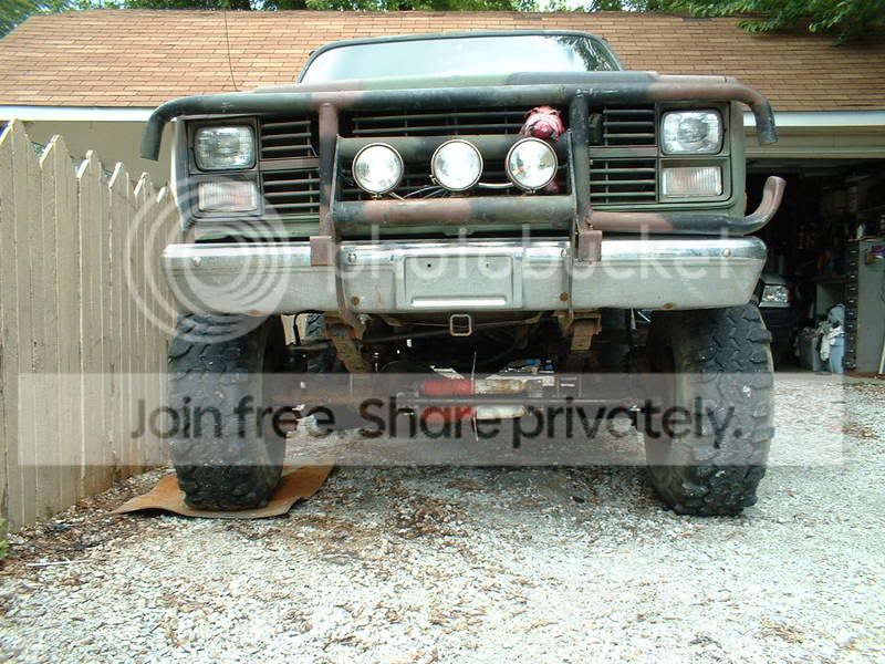

I made my own hidden hitch and is't gotta be far stronger than anything you can buy. I'll post pics on Monday of what I did. Allota Beef. Winch mount would slide nicely into it too.
Hoby
ya, im thinking about just going to the steel yard near me and getting sqaure tubes to build it myself. instead of having it drop down like the warn. im going to bolt a 1/4" plate on the bottom and inside of the frame and weld the main tube to the bottom plate.so its a little higher up and it wont torque on the frame as much as it looks like the warn would....o ya, for bumper clearance. i have a 2" body lift and the bumpers getting lifted to match the body lift....i think thats a good plan. but definitely post up some pics of ur home made one. it might help me out.

Shaun: Here are the pics of my home-made jobby. It is pretty damn stout and I get to keep the stock chrome bumper for now. In fact, my hitch has several good scratch marks where the hitch saved my nice chrome bumper. YOu should get a good idea of what I did. The torque should not be too bad on my frame since the actual female reciever is almost between the top and bottom of the frame. Here you go and let pic whoring start.
Only hangs below the front bumper about 1.75" and really doesn't affect approach anlgle. Atleast for the type of wheeling I do.
The "V" I welded on the brackets may be overkill but I put them on each side so there would be no tearing of the mounting plate since the plate has an area where it could tear if under heavy load but it could possible rip the frame off instead:eek1:
