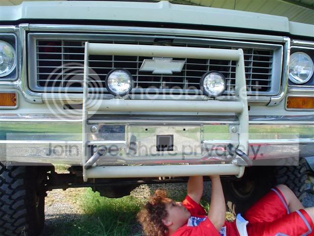

  8. dontoe
    dontoe 3/4 ton status GMOTM Winner
    Joined:
    May 7, 2004
    Posts:
    9,070
    Likes Received:
    Location:
    Hickory, N.C.
    I use both.................:D
    [​IMG]
