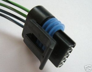

The IAC is located on the passenger side of the throttle body towards the firewall.
Depending on setup the connection should be
but also could be this type connector
The IAC controls the idle speed of the engine.
