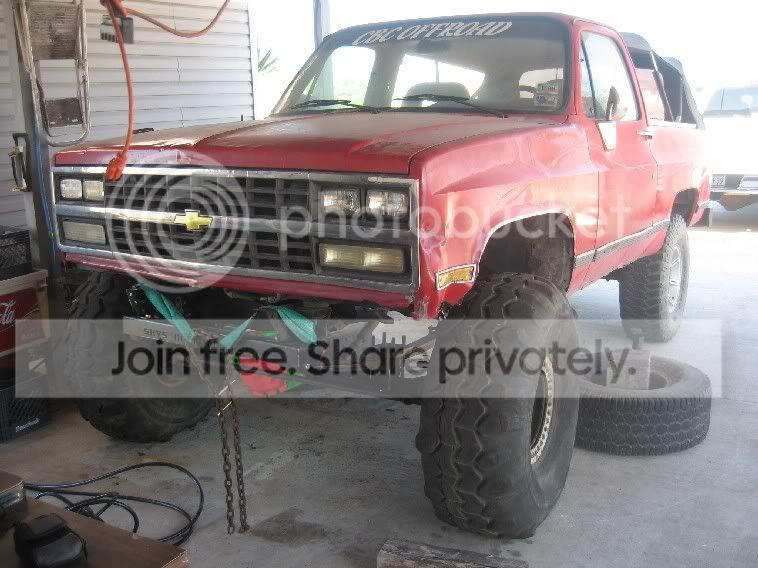

It is still under construction, but is a pic of it as of last weekend. It will be a trail only rig.
That's a sweet set up VT, wish I had gone that route when I built mine, but I'm a cheap bastard.
Thanks, followed it up with a flush mount gas door.
projectfreedom: That thing looks wicked with those 42's. :bow:
