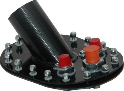

    I had a 20 gal RCI aluminum cell with the 90 ohm guage sender in my old K10. It worked really well and the sender worked with my OE guage perfectly.
    Things to think about getting: a roll-over vent valve to go in the cell @ the vent and a filler neck base with a flap to shut off fuel if the vehicle turns over.
    My only real complaint was that filling it was a b!tch!! Not having it hooked to the OE filler neck was a real inconvenience. Mine was lifted 10" with the cell mounted in the bed, climbing into the bed with a gas pump hose SUCKS! Do yourself a favor and spend some money on a filler neck, there are a lot of accessories that will work for us in the circle track market.
    Personally, I would be afraid of having a cell in the passenger compartment without some sort of firewall.

    Here are a the parts I was talking about,
    Roll-over vent valve (pictured as it would be installed in the roof of the cell)
    [​IMG]
    Filler neck base with flapper valve to shut off fuel if inverted (pictured upside down to show flapper valve)
    [​IMG]
