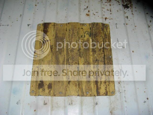

So I cut a access hole in the floor of my suburban. I am planning to add a access door over, but want to see what other people have done. I know what I am wanting to do, but want to see what others have done.
I went for simple, yet effective. I figure it's not something I'll need to access more than once every 3-5 years or so tops.
Rene
I want to do that, except hinge one side. The main problem seems to be finding a price that fits the Suburban floor. One of the ribs running length wise on the floor is double the width of the others.
Rene
Mine almost looks like this,,, but except for the yellow patch and no rivets.

Are you guys risky and cut these holes with the fuel tank in place? Or do you drop it to cut the access hole?
Those are screws, not rivets...and it is yellow (for now) and most importantly i did not personally cut the access hole, that was the mouth breather I bought this thing from. ;)
