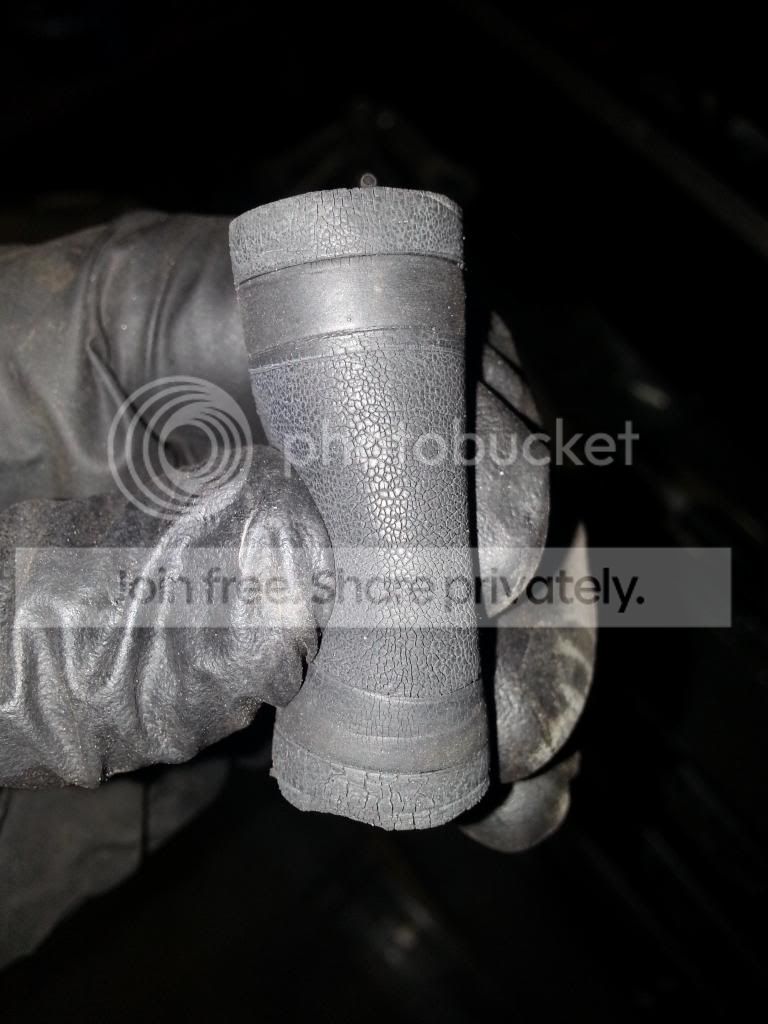

Here's what the little rubber hose looked like:
Squeezing it like that a couple of times really started to make it start splitting apart.
