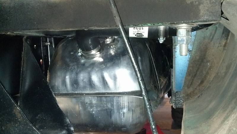

Now this RH tank is the high quality Canadian built Specta Premium from Napa. It is heavily aluminized….and built like a tank (hehe, nice play on words, eh...hoser :haha:) where as the LMC tank above is just painted garbage. These Spectra tanks can be procured through other sources besides Napa as well. I've seen them on EBay and Amazon too
