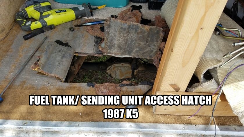

Cut you an access hatch if you didn't already. Plenty of reasons why.

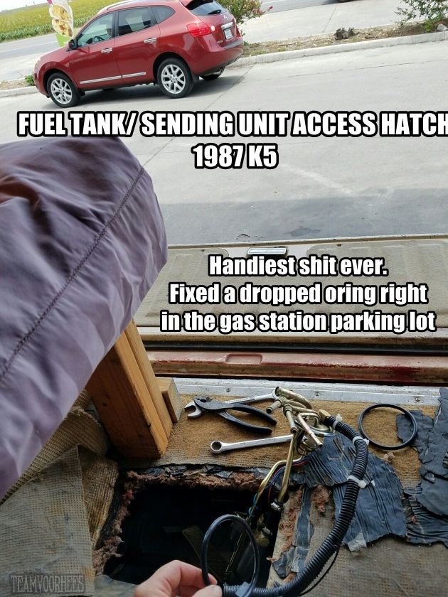

Here's one reason the access hatch is awesome. I removed the entire sening unit/pump and fixed the o-ring right in the gas station parking lot, without having to drop the tank
