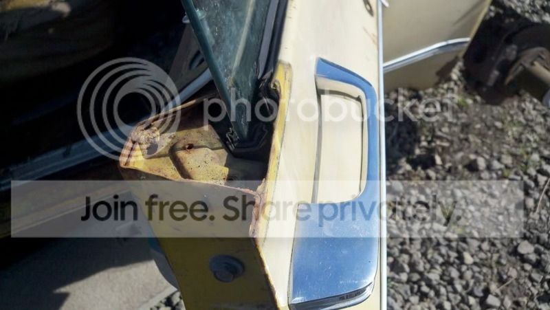

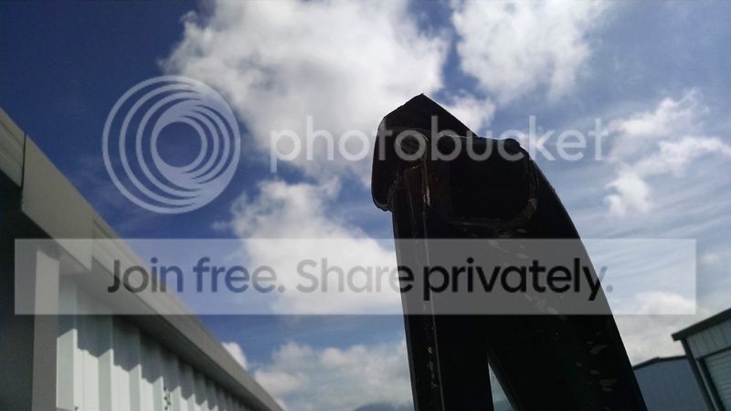

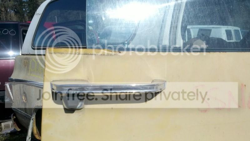

nvrenuf, I will try to take measurements of my blazer and the full vert doors for you. I think mine might still have the full vert frame with a cab welded over/into it

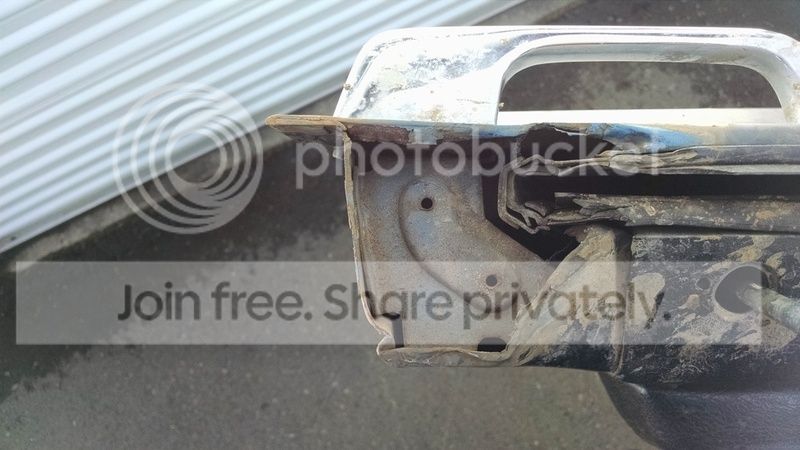

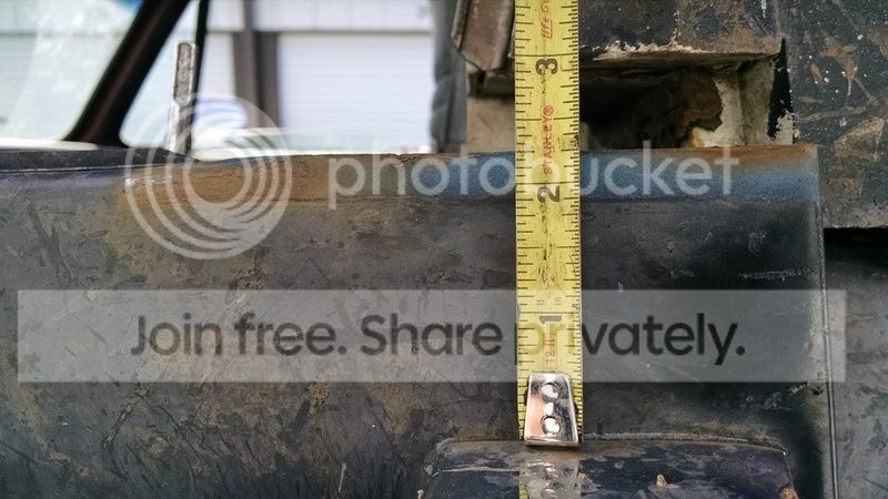

I finally made it over to the shop where the doors are, so here are some pictures in no order. If I missed anything let me know and I can get more.
Rubber to seal the door top meeting area
Up the Wing window view
I missed these the other day - THANKS for the pics! :thumb:

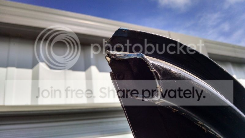

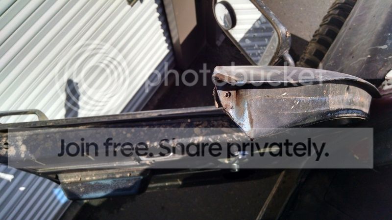

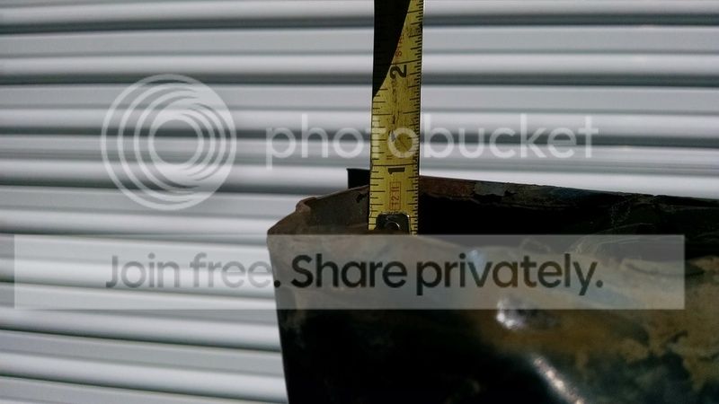

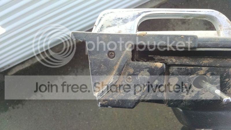

To help with others searching for info I have changed the thread title. Here are some door pics I collected this week.
Special THANKS and credit to 70_K5 and Biggs Chevy on chevyk5blazer.com for these pics. :thumb:

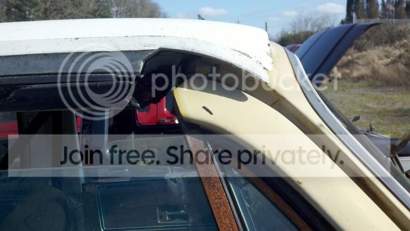

More pics -
Note that on the upper door cut there are actually 3 different angles needed to duplicate a factory door and also use the factory type rubber cover.
