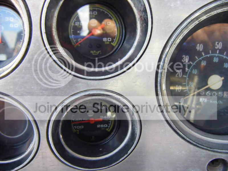

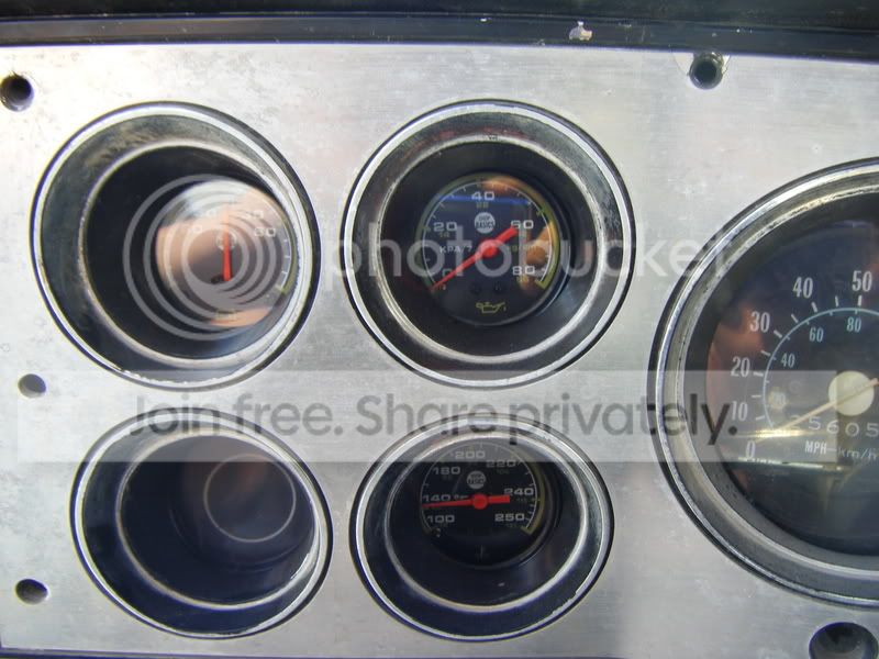

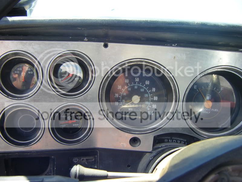

this is my set up, i really wish i could have fit the gauges without the chrome piece but i may take it back out and paint it black to match
That actually doesn't look half bad. Paint it black definitely though.

There's also a quartz clock option which keeps surprisingly good time. That fills the fourth hole, and looks better than the hole being empty.

or you could just do this :D
How hard is it to replace the fuel gauge with a tach and put a smaller fuel gage in one of hte small gage spots?
That is a good idea! That is what I will do. Are those the Sunpro gages from autozone?

so did you put the older model speedo in there also?? I had one of those in my '84 but every other truck has the 85 mph speedo in it. I like it
did the same thing with the gauges myself. You can just barely make it out but they fit pretty nice against the bezel
A couple of things I did, which I think are worth the time and trouble, are to use gauge faces with the same font and repaint all of the instrument needles with fluorescent orange paint. It makes the whole cluster look like the Blazer left the factory with it, as opposed to having been retro-fitted with it.
While I prefer the newer style font, the tachs were made with the old style and, in my opinion, it looks better if they're all the same.
I'd like to see pics of your dash man...
shaun love the set up, but how do you like the red? to me that would kinda be hard on the eyes but it may just be the way the pic was taken. looks great though
Red's actually easier on the eyes at night than any other color. That's why most OEM dashboards are either green or red. Green has just gotten the majority nod due to aesthetics.
