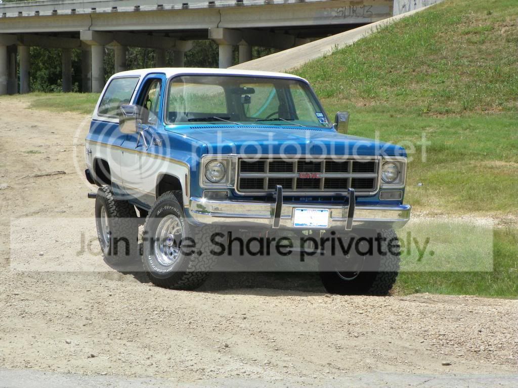

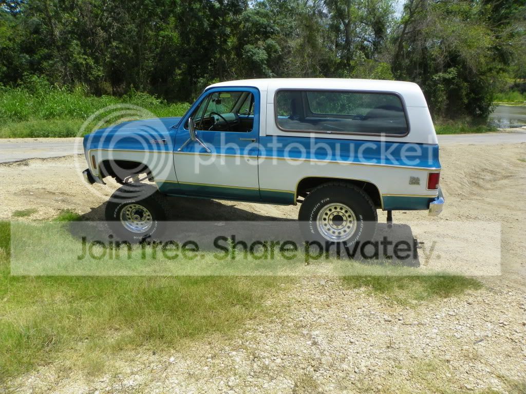

4 inch Skyjacker springs , kept the swaybar and lowered the bumpstops. Still gonna have to trim a little. Also going to have to trim the rad shroud , be cause of frame flex.

It appears that you might have body mount issues at the rad support though. might be worth having a closer look.

Ya that doesnt at all look right being twisted like that. You would expect the body to prevent that if it was bolted right.
Man what at you doin to me? Beautiful jimmy as always!! I would consider losing the sway bar or putting on disconnects. When I removed mine, it rode tons better, and flexes like crazy. I drive mine almost always on the road too. I Don't regret it.
Bolts are tight and the rubber is good. Maybe the swaybar is putting extra leverage on the frame while fighting the flex. It did this when it was stock. Back in 87 I had a stock 77 K10 that I wheeled out at Saguaro Lake out by Mesa . The fan would hit the shroud on it also. After I trim the fenders , I'll take off the bar and see what that does.
