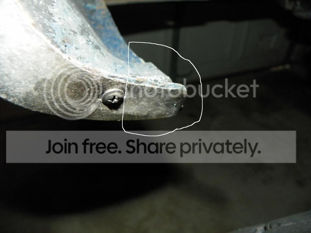

Yes. I'm going to trim from the last screw for the molding and go in.

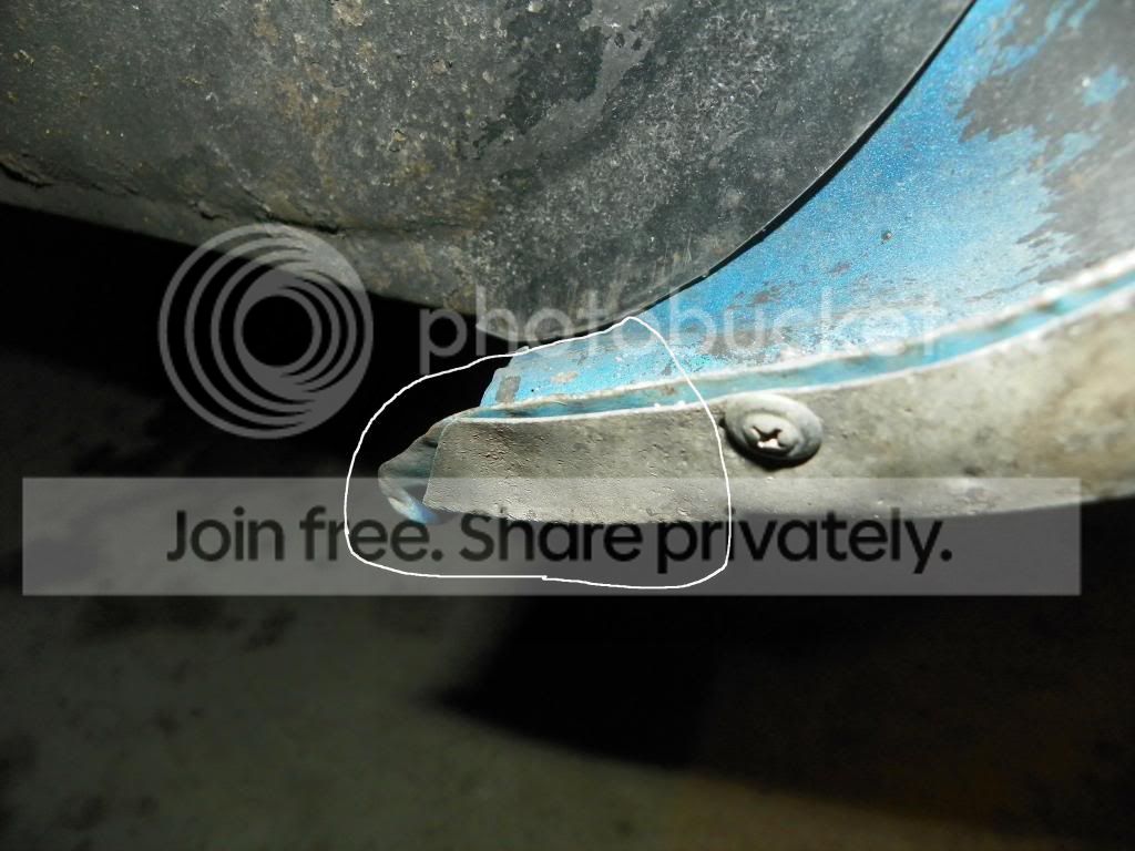

My issue would be worse if I moved the axle forward. The second photo shot from the front with the wheels turned to the left , the tire is touching the fender. When I turned the wheels straight the tire pulled the trim of the fender.
I hear you about not wanting to cut metal , but I did a lot of thinking about that and decided I was willing to trim a little. Otherwise I would have left it stock.
I have the same tire/rim and lift size. Mine rub just a touch, but I wouldn't put a 1" body lift. Then it wouldn't fit in the garage anymore. Thats just how close it is.
I have just been watching when I turn into driveways and such. Sometimes I slow down a bit and turn the wheel more to get the edge of the tire past the corner of the fender.
What about trimming the edge off the fender, and folding the trim over?
Yea , If I go any taller it won't fit in the garage. On the street mine does not rub at all. I have to go park in a ditch and turn the wheels for it to rub.
