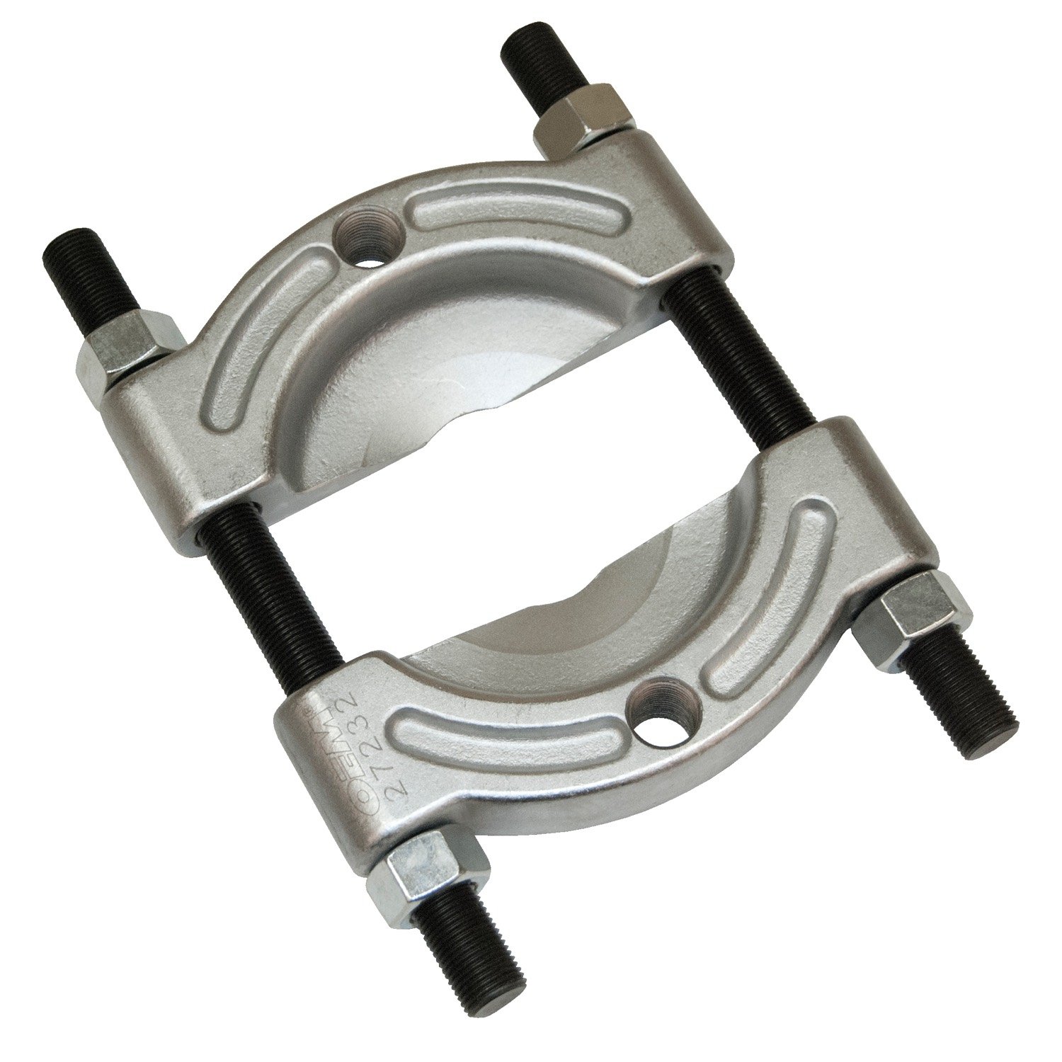

This jobber with bolts in the side holes to pull the bearing off the ring gear side was the wrong way to do it. A cut-off wheel and an air hammer would have been a much righter answer. But either I didn't have those tools here, and was too lazy to run to work and get them, or I was too impatient to deal with my air compressor that is too small to run a cut off wheel.
