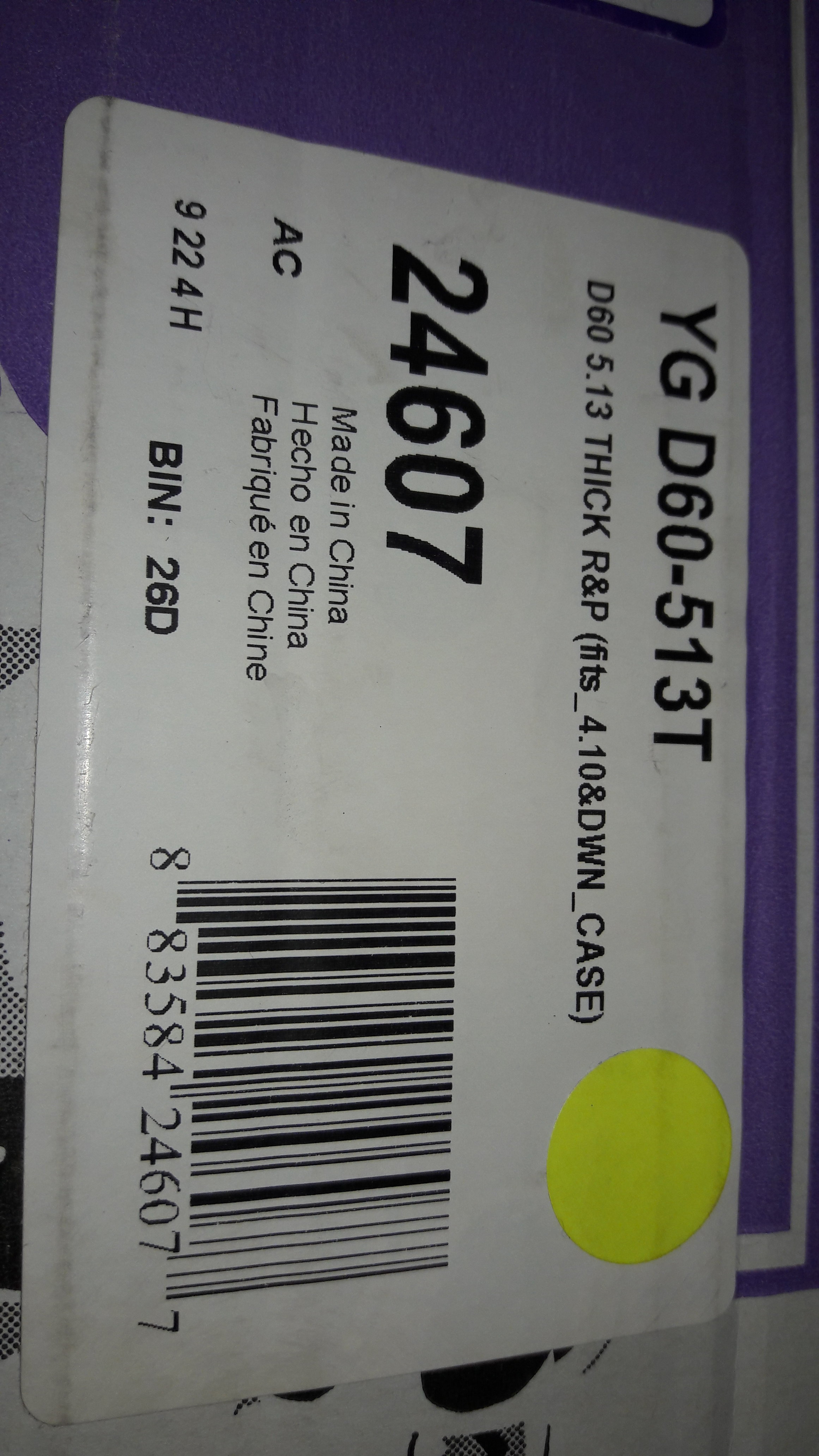

If anbody was wondering where Yukon gears are manufactured here you go.
full
Koyo is factory for years . I would run them ..
That is what I said to the guys at Ron's Machine Service when they told me they could not get the Timkens. My 14-Bolt has over 300,000 miles on the original Koyo bearings, and they still work fine. At least the Koyo bearings I got say "Made in Japan" instead of China.
