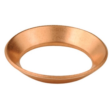

Anyone heard of using a copper flare gasket to help seal brakes?

Also,no flare fitting needs a "gasket" or copper shim,if it doesn't seat properly,I'd cut the line and re-flare it and try again...
That copper flare idea came from various auto forums I cam across while surfing on this topic. Apparently the gaskets are commonly used in refrigeration type applications, but will work on brakes. People seems to especially have trouble with stainless lines since they are less malleable.

It looks like I have it sealed anyway (knock on wood), but it's not like it's a trivial thing to reflare the line. In this case there's no extra line to spare, so it would entail ripping the who hard line out from inside the frame structure and replacing it. If I'd spent $$ on prebent SS lines, I'd be even more hesitant. I don't see anything inherently unsafe about using the copper, as long as it doesn't limit the amount of thread engagement.
I would be interested in giving those copper washers a try on a SS line but on a standard steel line it should be unnecessary. Ive had fittings so temperamental that Ive had to get that last 1/8 crank on them with vice grips to seal up. Not really advisable but it was a quick flip car at work and replacing the line would have been a huge waste of time.
