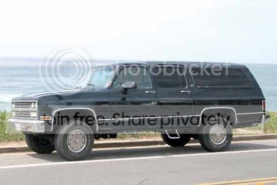

Well, since build threads are all the rage these days, I figured I'd jump on the band wagon. Here's my '91 burb as it was when I bought it about 2 yrs ago all stock.

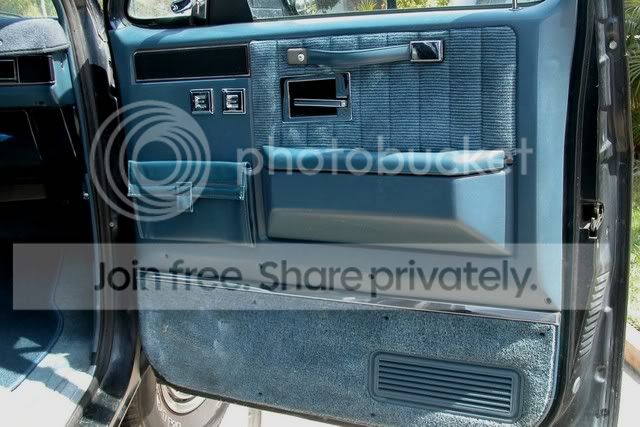

-changed dash and door trim from woodgrain covered in plastic carbon fiber to a flat black finish

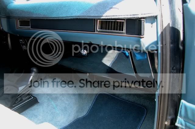

(probably remember some more stuff and add it later. I'll also add some pics of the alarm install, and dash changes.

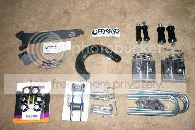

Here's the stuff from ORD except the springs which will get drop shipped.
Great on the phone, fast shipping, and looks like quality stuff. Kind of makes me wish I'd ordered more of my stuff from them. :dunno: But I found out today that my wheels are back ordered until middle of April, so I guess I can to be a little patient. :wink1: Patience makes the heart grow fonder. :rolleyes:

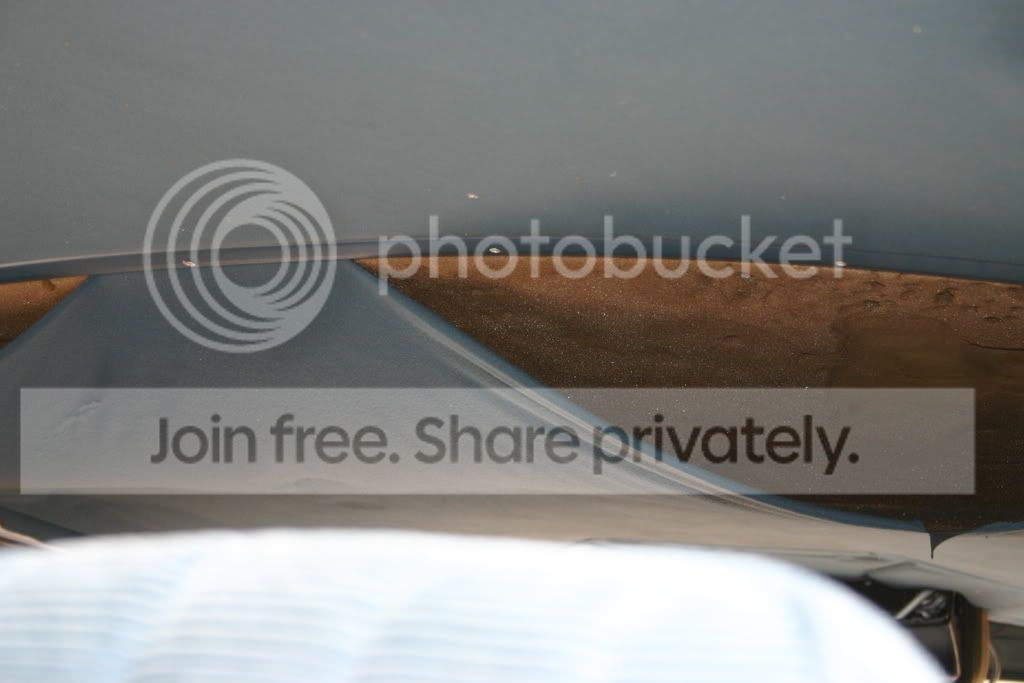

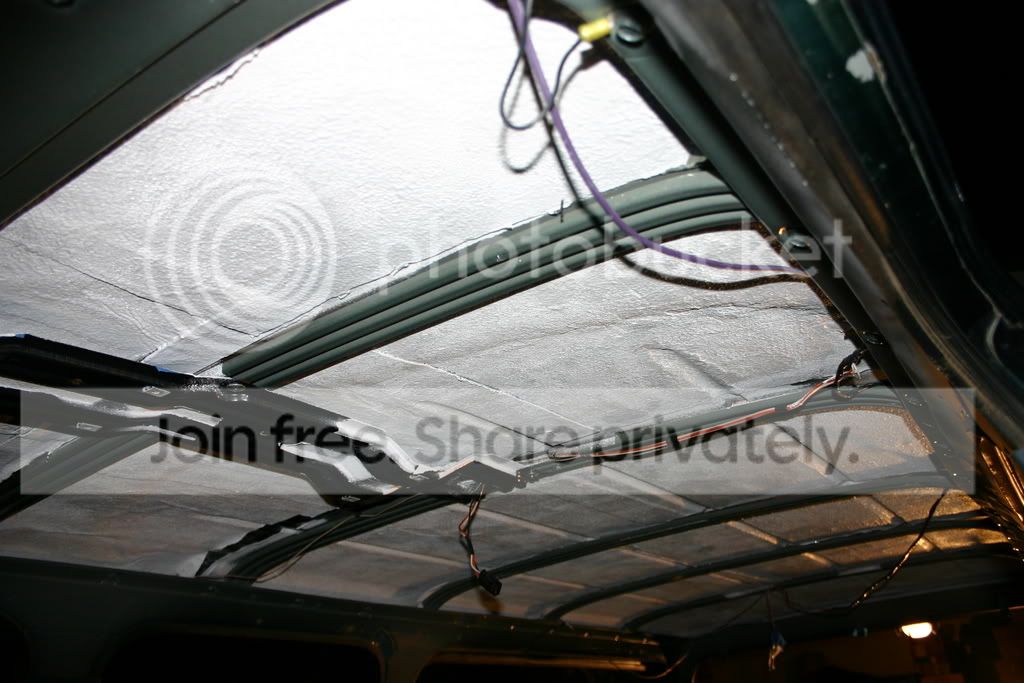

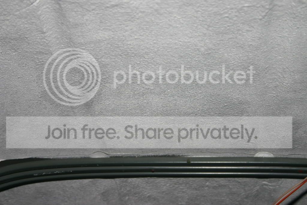

My headliner was falling down, so I needed to replace it, but I promised myself whenever I replace anything on the burb I'd make it bigger or better. So, being in AZ I wanted to find a way to make it better by making it cooler. I did a little research and found a company that was locally based, but doing business all over the world called Second Skin Audio. The product that interested me was called spectrum heatwave. It is a ceramic coating that absorbs heat and sound. Perfect. But since it is waterbased I didn't want to put it staight on the sheetmetal, so I used another one of their products called damplifier pro to go straight on the sheetmetal. Then I put the spectrum firewall on top of that, and last I'll put a layer of a familiar product called heatwave on top of that (seen it before at Mesa Sales). Sounds a little overkill I know, but that's what making it bigger and better is all about, right? Plus I never want to take down that PIA headliner again.
Here's the headliner before

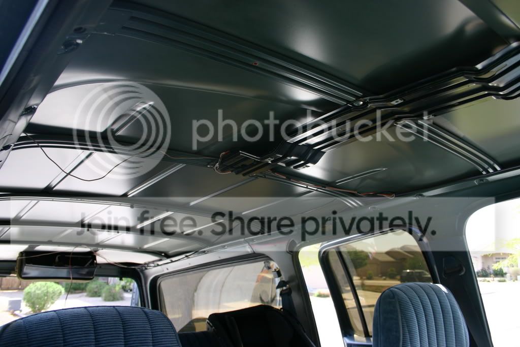

Here's trim and headliner removed

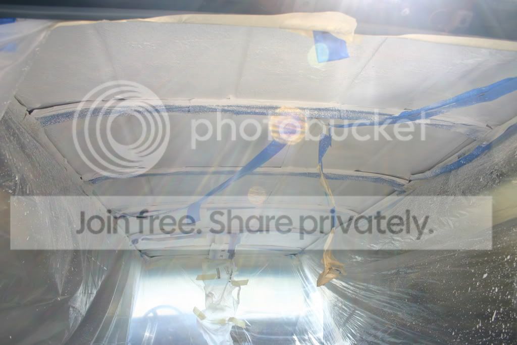

Here's the layer of damplifier pro. It's similiar to Dynamat pro, only better. It basically consists of a butyl based mat with a layer of aluminum on top. It is formulated just for use on autos, so it withstands temps of over 450 degrees and makes a permanent bond, unlike asphalt based mats which can fall off after time and smell bad.

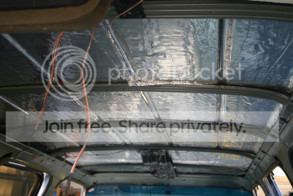

Then I masked everything off and used a bedliner gun to spray on the spectrum firewall ceramic coating.
Here's a close up of the finish texture
and the whole roof
Now, I'll let it dry a couple of days (even though it's already dry to the touch) and put up the last layer, Heatwave.
A side note, you can also bedliner over spectrum, and that's what I plan to do on the floorboards. One layer damplifier pro, then spectrum heatwave, then grey herculiner (yes they make it) over the top. That way I'll have a weatherproof and quiet interior. (however it takes spectrum firewall 30 days to fully cure before putting a waterproof product like herculiner on top ot it, so I'll put my carpet back down for a month before I put down the bedliner.

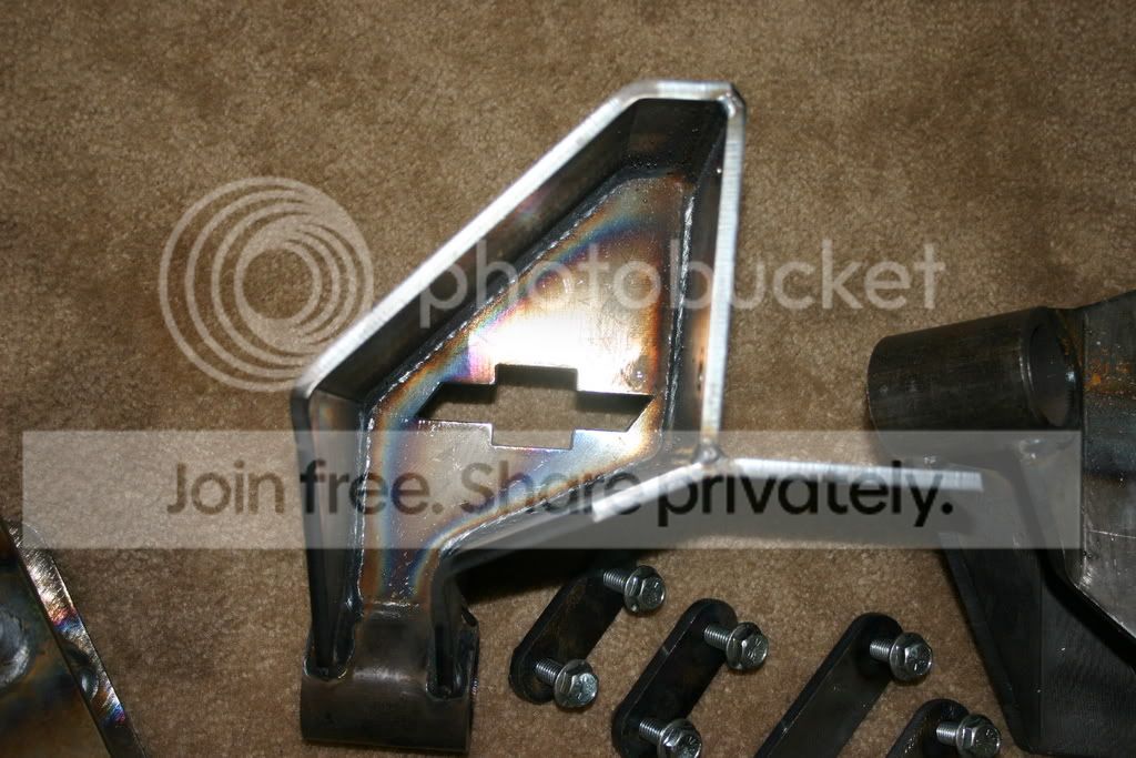

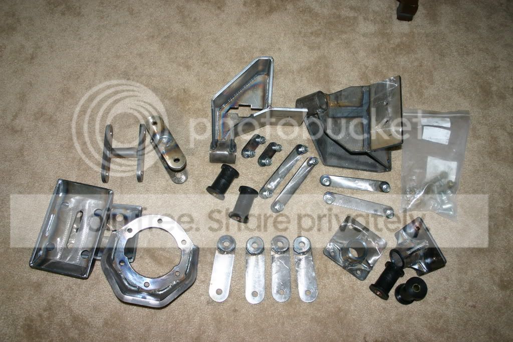

The DHL Man brought me a super heavy box today :eek1: , and look what was inside (mmm Beef, it's what's from DIY :D )
DIY4X
Shackle Flip & Switch (w/custom bowtie)
Cross Tied Shackles
Front Shackle Frame Eye Hanger
4.5" Shackles w/heavy washers welded on for width
14BFF Guardsman
14BFF Ubolt Plates
I'm so stoked these parts are beefy and sweet. Can't wait to paint 'em up and get them installed.
BTW, these came in a week earlier than expected. GO KERT!!
Oh, almost forgot this pic
Pictures don't do these parts justice. They look incredibly thick and tough.

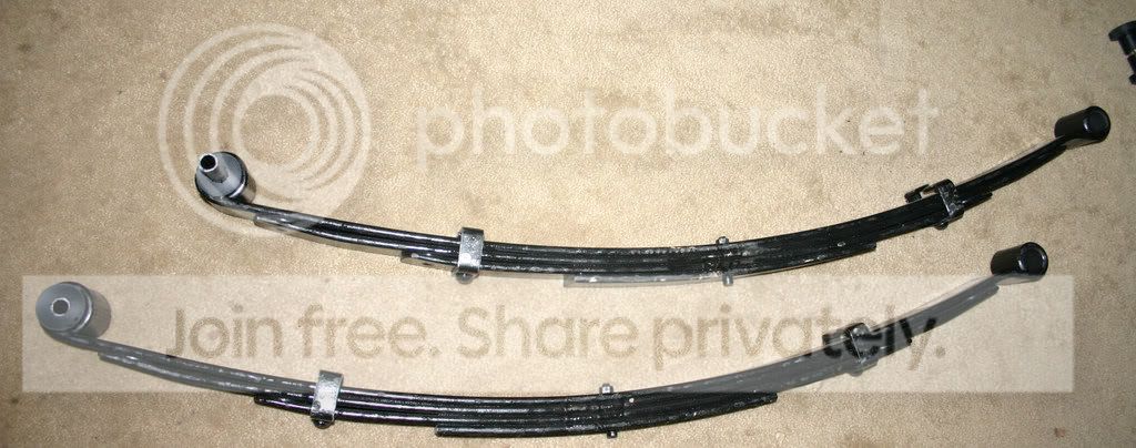

Late yesterday afternoon the UPS fairy paid me a visit. :D
Tuff Country 4" lift springs courtesy of ORD

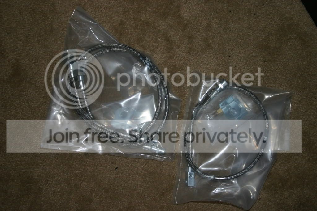

Beefy Extended Brake Lines from Black Widow Products
