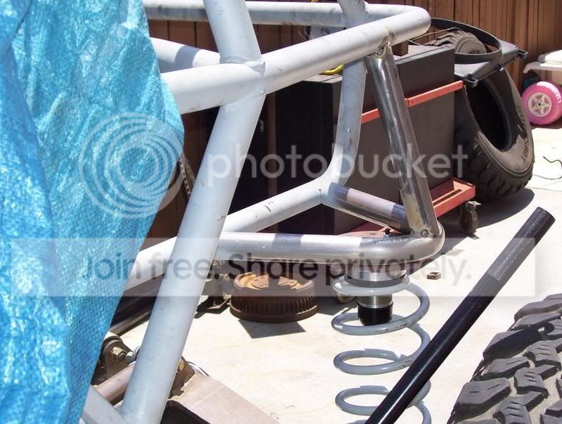

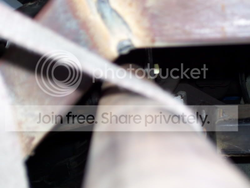

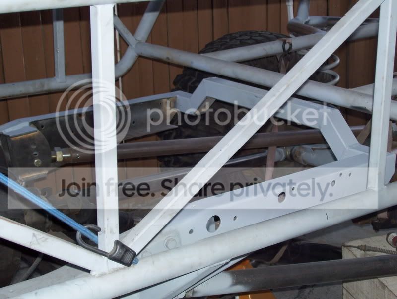

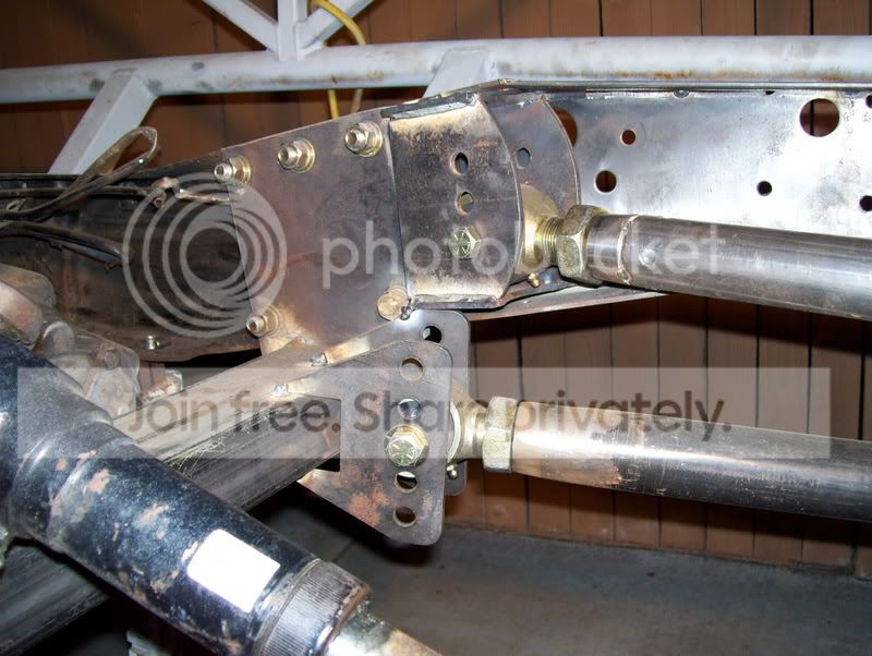

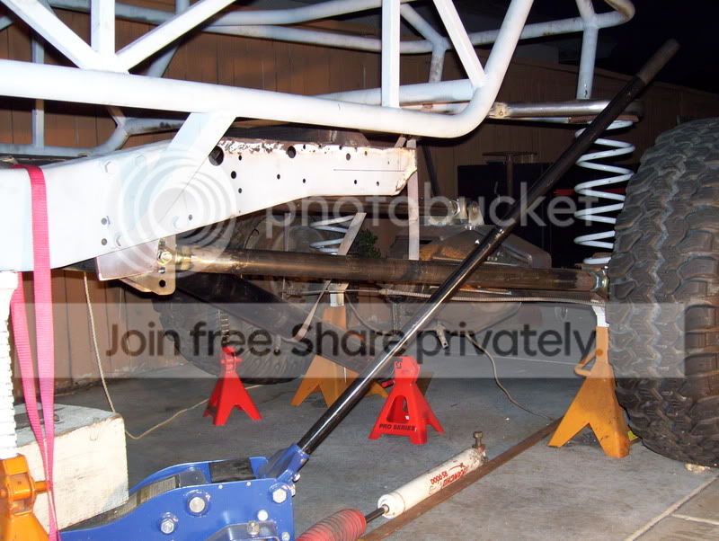

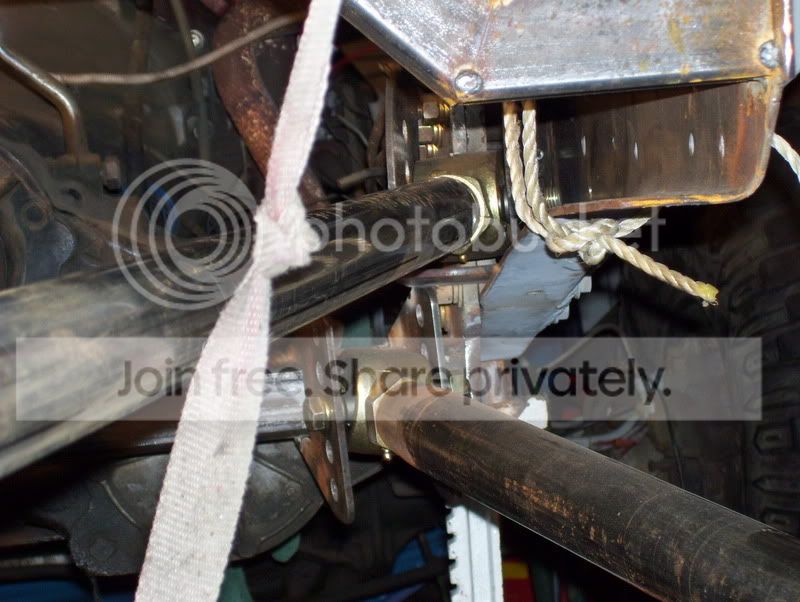

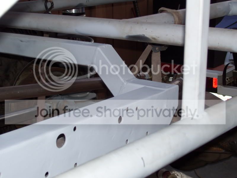

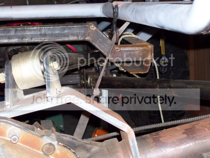

Updated pics with 4 link tacked in place and cycled

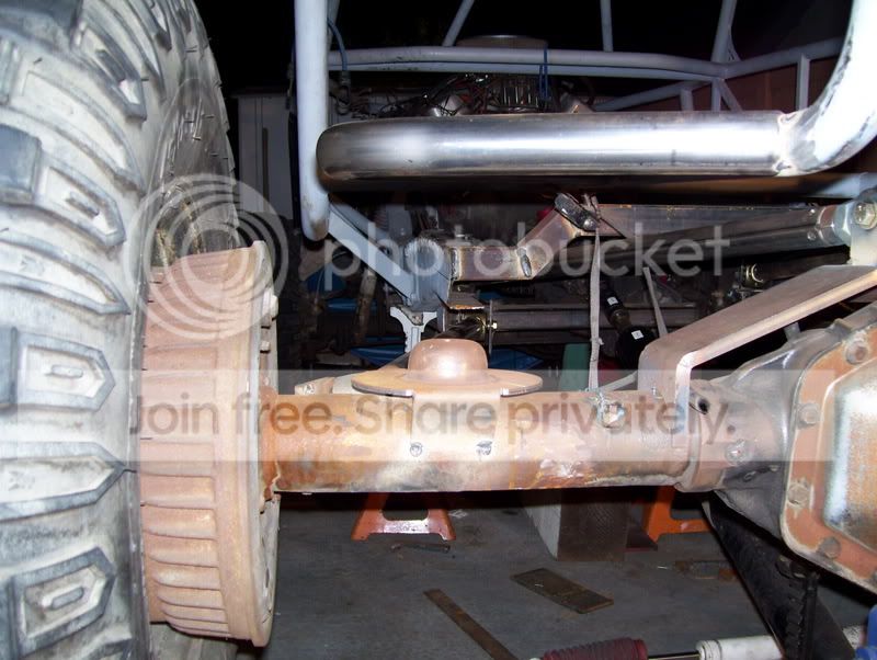

I finished my measurements and tacked in the upper axle end tabs. It's articulation will be somewhat limited by the acos adjustor and bump kit but Im not too concerned since I dont plan on rock crawling it on any hardcore trails. I will be doing mainly dezert and sand dunes.

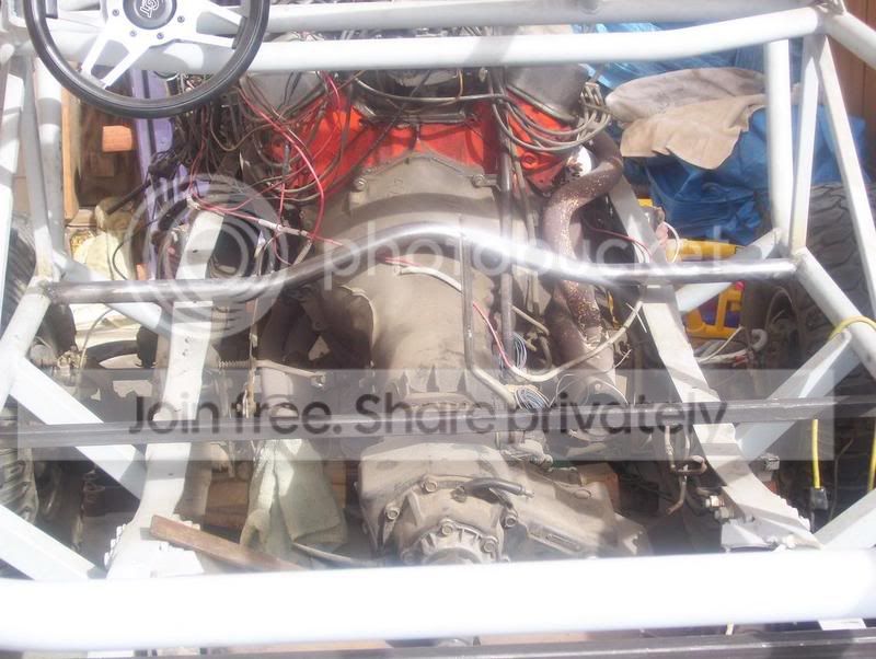

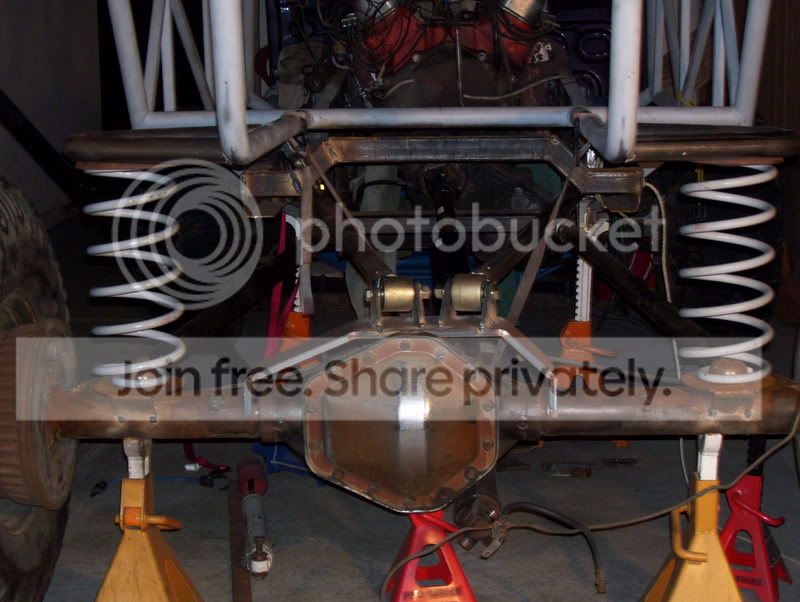

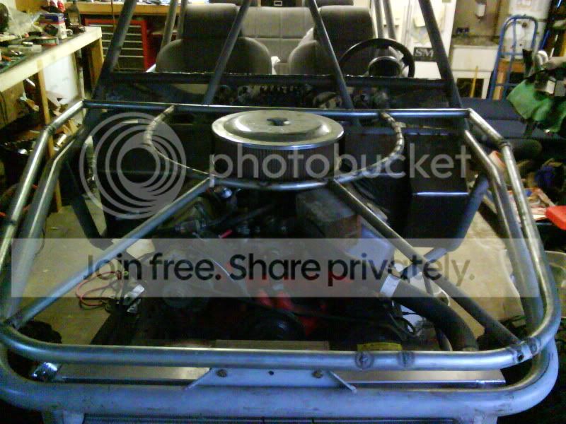

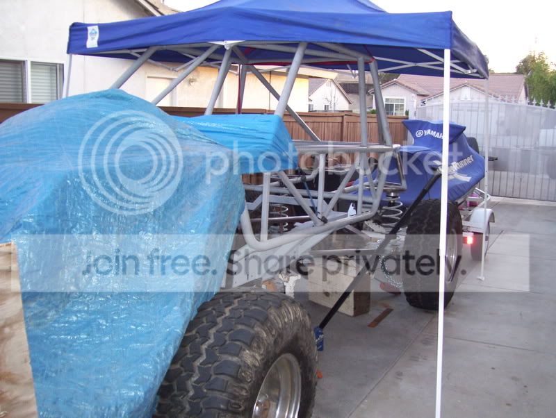

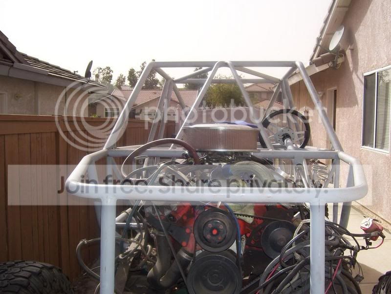

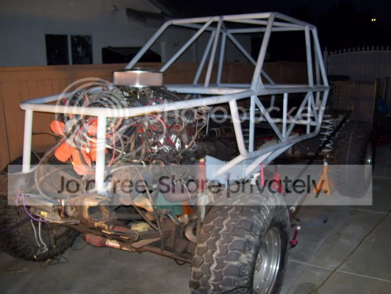

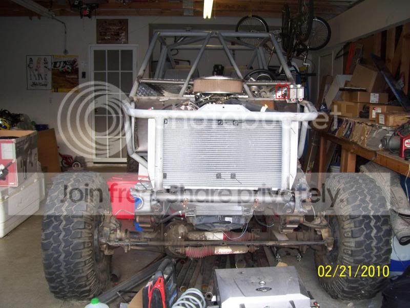

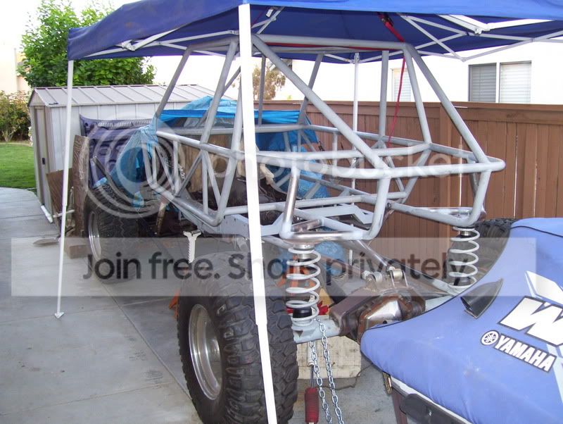

Here are some front and rear shots.

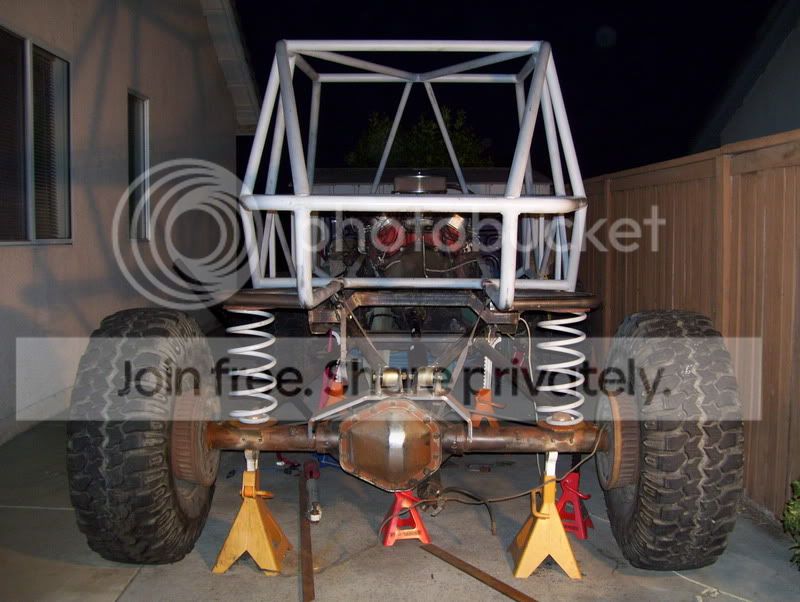

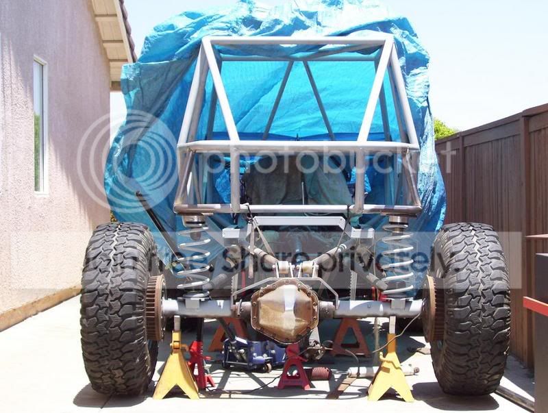

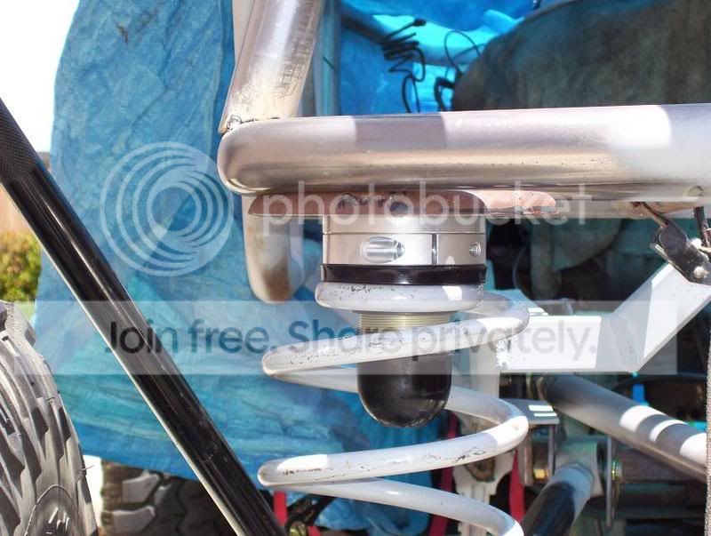

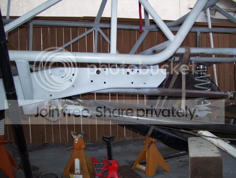

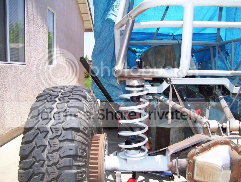

Here are some articulation and some clearance shots.

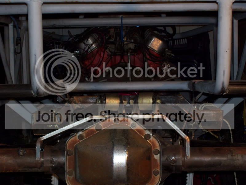

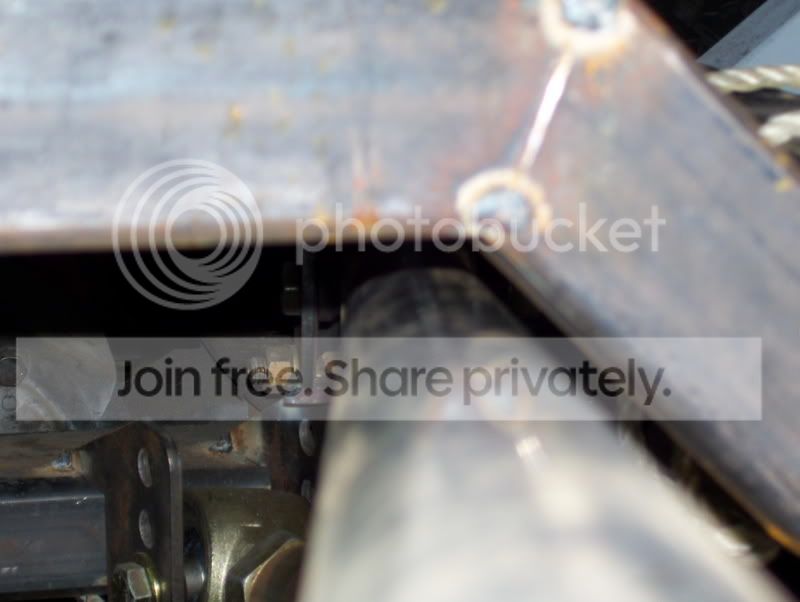

Here are some more clearance pics at full bump.It will probably stop before this point because I will have an acos rear adjustor from a tj and a currie bump kit.
3 quick questions for ya
whats the overall height of it?
to the bottom of the frame?
and what size tires are those?
Roof near the front is 76.5in and near the rear is 76. Rear has no weight on it yet and I have not touched the front suspension yet it should get a little lower. It has 6in front 3/4ton springs right now and I'm putting in a stock 52in front spring until I can get all the parts for 4 link in the front.
Lowest part of the frame around the transfer case area is 24.5.
Tires are interco trxus 35x12.50x16. I had 16x38.5x16.5 swampers but they were new and wasting away sitting there so I traded them to a guy on the board so he could put them to good use.
The truck will end up with 37x13.5x17 Nitto Mud Grapplers.
yeah I'm aiming for 37's for mine too.
either the Irok, Bogger or the truxis like what you have now.

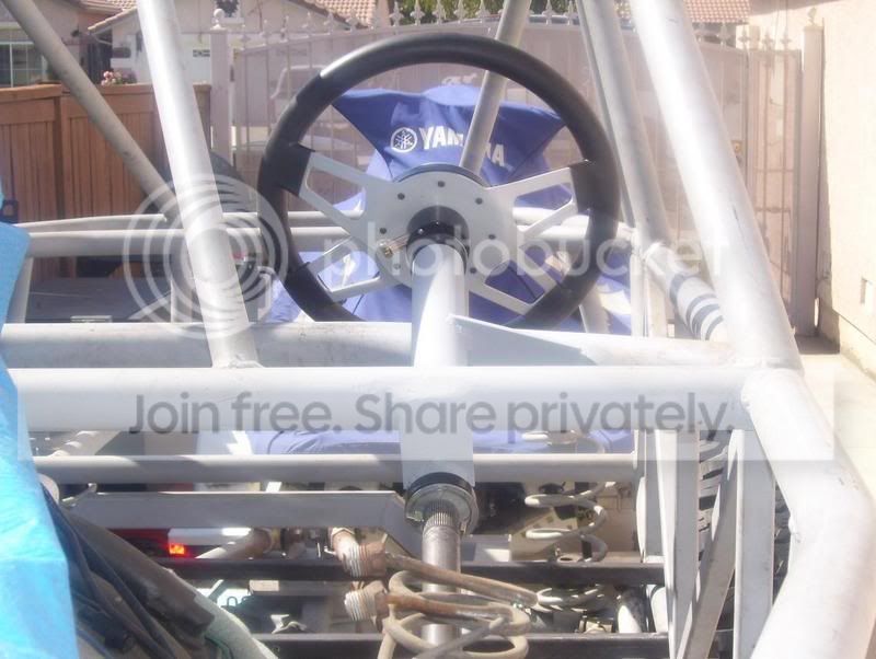

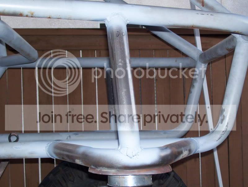

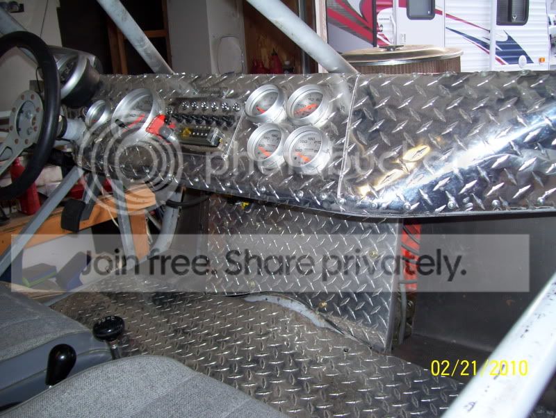

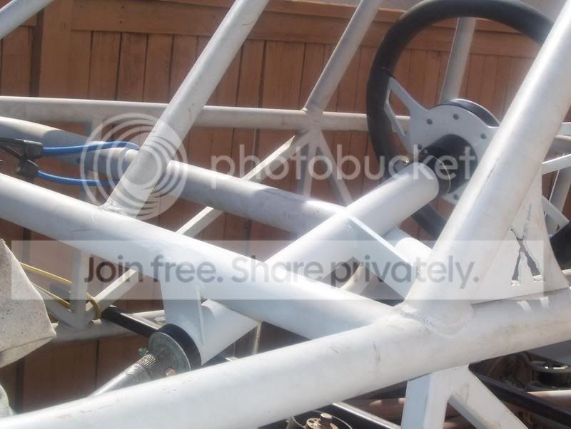

Started the steering column with new steering wheel and quick disconnect and and floor structure.
Front Shot
Front-Side SHot
Steering column
Front Steering Column
Floor Structure Started
im digging that steering set up!
nice, how how is your drive way so clean?:eek1::haha::bow:
:haha:I spend about as much time cleaning as I do fabbing. I have 3 kids that all like to watch and play around the buggy so I got to keep it clean or they will track it all through the house.
looking cool, are you going to have a "door" or just climb over that boatside?
Just the other day I was wondering about this thread, glad you updated it - looks really good! I like the hood "frame" too, neat. :thumb:
