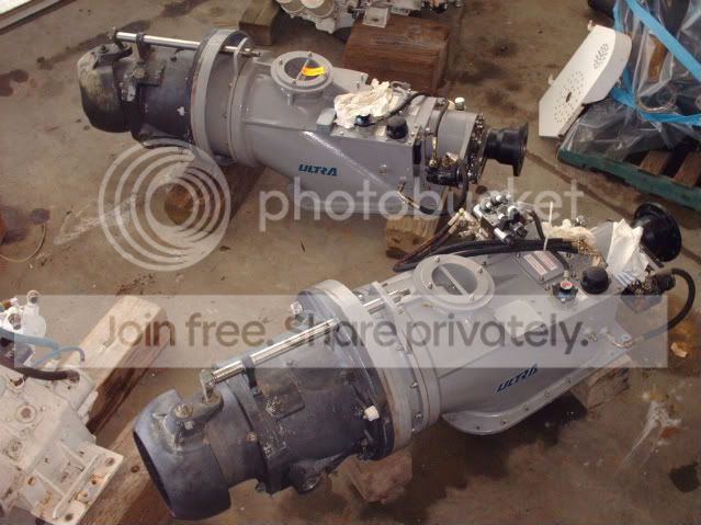

now, when I worked for Hinckley, I wanted to strangle their electrical engineers.... :haha:
OP... ya may wanna see what kinda amps your drawing with everything on to see how bad your working that alt....
Hinckley makes some cool boats. Old school look. Nice stuff.
we called em champagne sippers... big big bucks.... all jet drive and such... the company was ghey tho... :haha:

Champagne sippers fits. They look like big bucks. It's writen all over them. I know the jet thing. They make for a unique handling boat. Most of our larger fire boats and pilot boats are jet. Lots of twin Cat C9s and Hamilton 322s. Some Cummins and a few John Deeres.
