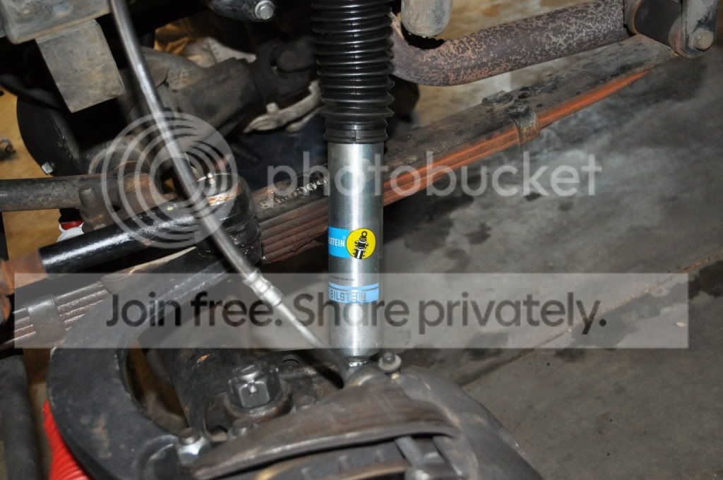

Well, I got the shocks last night and lined them up with my existing onea. At full extension for the front, it would have JUST bolted in without anymore extension.....obviously, the wrong shock.
I called this morning to Bilstein directly to find out which one's I needed. Glad I did! 4WheelParts sent me the 5125 series vs. the 5100 series. The Bilstein rep asked why I ordered those instead of the 5100's because the 5125's only have a 90 day warranty whereas the 5100's have a lifetime warranty. I told her I did order the 5100's but 4wheelparts sent me the 5125's instead. And to boot, the wrong part numbers too!
