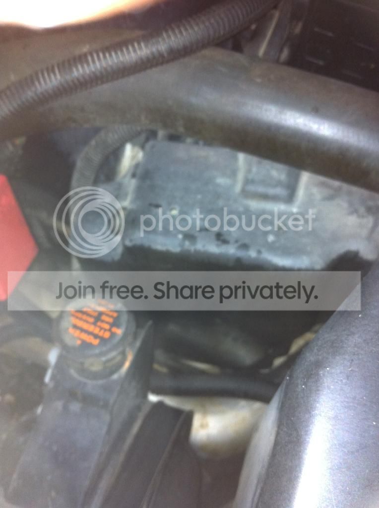

My 02 Duramax sprung a leak!
I can`t see were it is coming from?? Anybody go an idea where it could be from
It`s not bad but I can smell it and you can see where it is spraying on near the P/S pump to the right of it.
Probably the weep hole on your water pump. Look up from the bottom for a better view
Yeah I think it`s the water pump...good times! :haha: I thinks it`s a 4 hour job, with the right tools! :doah:
