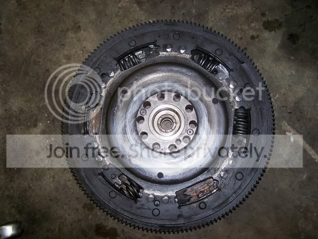

Something else I just remebered is that Ford used a "dual mass" flywheel for a while (I know my 96 had one) and would sound lopey when it started goin bad.I'm not sure how long they used that flywheel but its a $600 deal if you have to change it.
