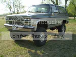

these are pics from TOMUCHSTUFF's build. the front clip is all aftermarket fiberglass stuff I believe

I think the hardest part would be cutting the fender to fit the turn signal/running lights, what if you cut the grill at the outside and moved them to the inside??? excuse my paint chopping lol.
Or you could just use the turn signals on the inside of the grill from the earlier 80's style instead. Then I think you could cut the newer grill to fit pretty nice.
