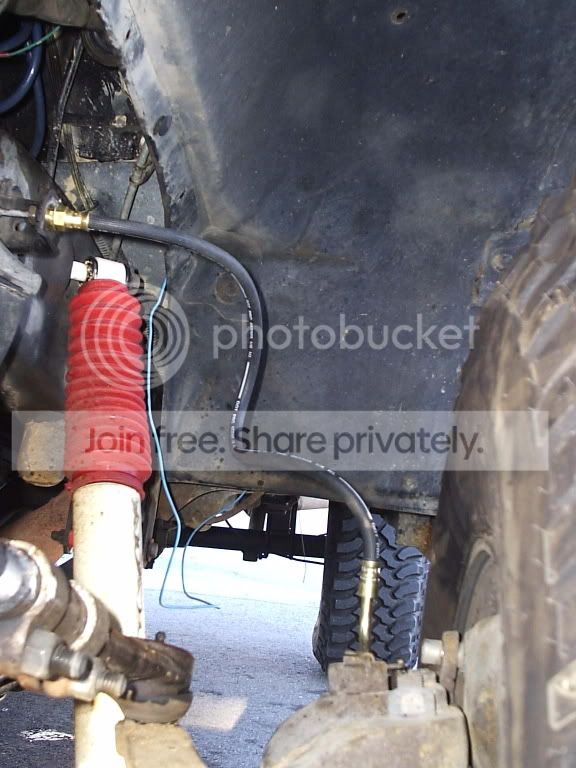

longer brake hoses, you can find part numbers in the part numbers thread..

Gabe, ok on the BFH, but on the break lines, I have the drop down brackets - do you think the break lines will still be needed on a 4" lift?
The drop down brackets for the brakes are a little cheesy. They'll get you by for now but it would probably be a good idea to replace those 17 year old lines at some point in time. I wouldn't cut a hole in the floor, just run the breather hoses to the top of the firewall like I did. It's extremely easy and you'll hydrolock your engine before you'll suck water into the diffs. The steering arm uses studs & nuts, not bolts. Your kit should've came with 3 self locking nuts for bolting the new arm on. It's mostly straight forward but there's a few tips & tricks to installing a lift. Have you ever done one before?

I didnt use them at first and it was fine until the brake hose becomes the limiting strap when flexing...
Napa United: 38622, 38623

As said. Get new longer brake hoses.

I ordered the new brake lines yesterday. I just wish I had seen Georgia Gabes post before I ordered them. I would have gone to Nappa for them instead of RC.
