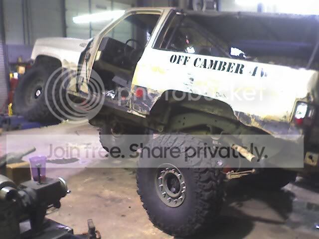

Gabe!! Finally a pic to show people what Ive been talking about.
The 12blt H1s are a different animal than the 8blts. Notice how small the center is? You have to cut out the front center and weld a new center to the rear.
Maybe Gabe can explain it better with more pics lol.:D
You can cut them 2 ways, like Gabe has them cut inside the "ridge", or you can cut them on the other side of that "ridge" closer to the beadlock bolts. Cutting the "ridge" out give lots more room to get to the lugs and whatever else when recentered.
I bought mine already recentered from Ryan22re. I dont know what the backspacing is but I can measure if needed. I like just having the center cut out of the outers, I think it makes it stronger and you dont get as much crap up in them. I can just get to the lugnuts so no biggie. I will say that putting them togeather with the Orings can be a biotch, but plenty of grease on the oring and tightening them in a criss cross pattern like a drumhead worked for me. I also would suggest putting in some airsoft pellets to balance them before you assemble.
