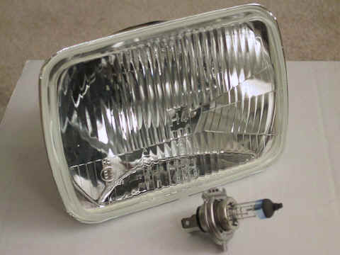

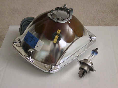

well i just ordered the 4x6.5in of JC Whitney, they basically screw in and out but i had to bend the light sockets on the truck a little so the new headlights fit real snug, on the lights it also says only use a 55/60 bulb, i think cuz there kinda cheap and will melt the inside with anything else bigger/hotter, i also got the normal h4 bulbs not the hyper blue ones. the blue ones would reflect the whole headlight blue like my fog lights do.. anyways, yea just a plug and play type of deal, cept i have to change the high beam set of lights to a 3 prong plug instead of 2..
Do you have any pics of the install? So this a composite style headlight like on newer vehicles then? Has a case with a bulb that goes in the back?!?
Kris
yup, just like that, so when my lights burn out i just replace the bulb..
no pics of the install, basically 4 screws, that's it.. i'm going out to take some night shots and drive around for a while.. they'll be on my webshots a little later..
You replace the Sealed beam unit with a H4 unit, which allows you to replace bulbs instead of the whole sealed beam. I did it on mine to retrofit HID's Xenon lights in. /forums/images/graemlins/smile.gif
