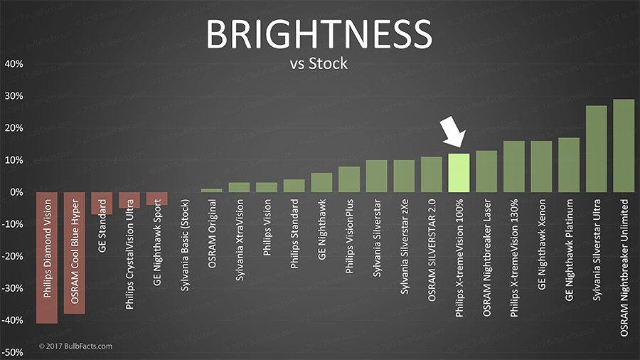

A great resource for researching bulbs is https://www.bulbfacts.com/halogen-bulbs/chart/. They actually test all the bulbs and show that "upgrade" bulbs are only slightly brighter than standard, but with a lot shorter life. For example, the Racing Vision "+130%" is 24% brighter than standard, with less than 1/3 the lifespan, usually 3x the cost. Usually upgrading the wiring will give more improvement than a bulb upgrade. When you get into the higher power bulbs (i.e. not DOT) the wiring resistance is more of a problem and the bulbs can end up dimmer than stock - until you're able to really put the voltage to them.
Just think it through - these bulbs are basically all rated for the same power, so brightness will come down to efficiency and burning hotter (halogen vs halogen). If it really made 130% more light, a 55W bulb would be 126.5W and melt your socket and housing. I think they're referencing the peak brightness at a point on the filament (which must be smaller), but what a driver really cares about is the total light going down the road. So they mean "130%" or "+30%", but putting "+130%" on the package is just mathematically incorrect.
