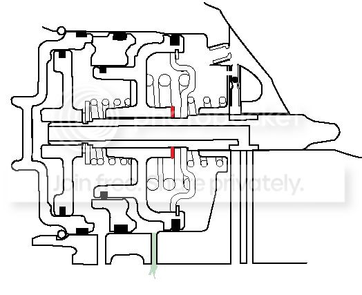

Nearly all 700's will exibit a harsh down shift coming to a stop when left in the D range. The servo piston bottoms out against the cover over the third accumulator spring when shifting down to second due to routing of accumulator oil in third gear. You can usually soften this by cutting down the center of the servo piston under the cover so the spring will compress further absorbing the hit instead of the piston to cover contact.
When shifting from 3-2, you are applying the inner piston of the servo. It moves back out when shifting from 2-1. How is the oil routed differently in here in D vs. OD? There are 3 springs in this diagram. Are you talking about making more room for the right side of the left spring?
talking about cutting that shoulder of the 2nd gear apply piston in the center that the band pin rides through, on the side of the 3rd accumulator spring and cover.
So cut where the red lines are, but not so much that the accumulator cover bottoms out around the outside diameter?
Take about an eighth inch to three sixteenths off the area in red, I usually cut it down to the bottom of the "chamfer" on the center hole the pin goes through. I do it on a table lathe but you can use a grinder, it won't hurt if it is ugly and uneven, just so it keeps the piston from bottoming against the cover. Where did you find those sweet illustrations by the way?

To Greg: this is great information that I searched for in the past but until now nobody was able to tell me.
To reece: Now you just have a quick one evening project ahead to fix this. Yes, a lathe is not required as this is not a rotating assembly. Even in the slim chance the piston got messed up, they are available at any local transmission shop or dealer parts counter.
