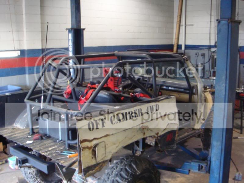

I already have a cage, here is what it looks like currently.
