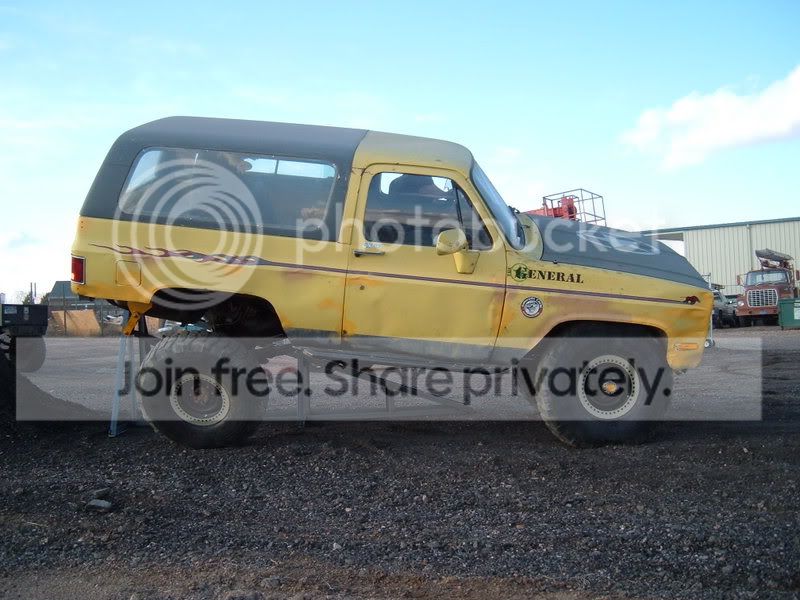

Ask and you shall receive
This was when I had 4" Tuff Country EZ ride springs in the front and an ORD 4" shackle flip in the rear. In this pic, the swaybar was still connected
