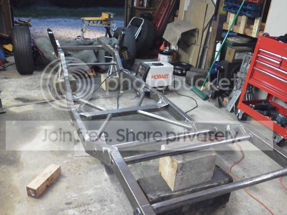

Edit here is what Stomis did for his trooper
If you're good with a tape measure and welder, it's only time and materials. If I was building something ground up that I want to keep for the rest of my life, this is the direction I would go.
What I did would be way easier with a truck than an SUV like mine or a blazer IMO. If you're going to link it I would do a 2x4 center section to the extent of the link mounts, get the middle section of the cab mounted and use round tube from there.
