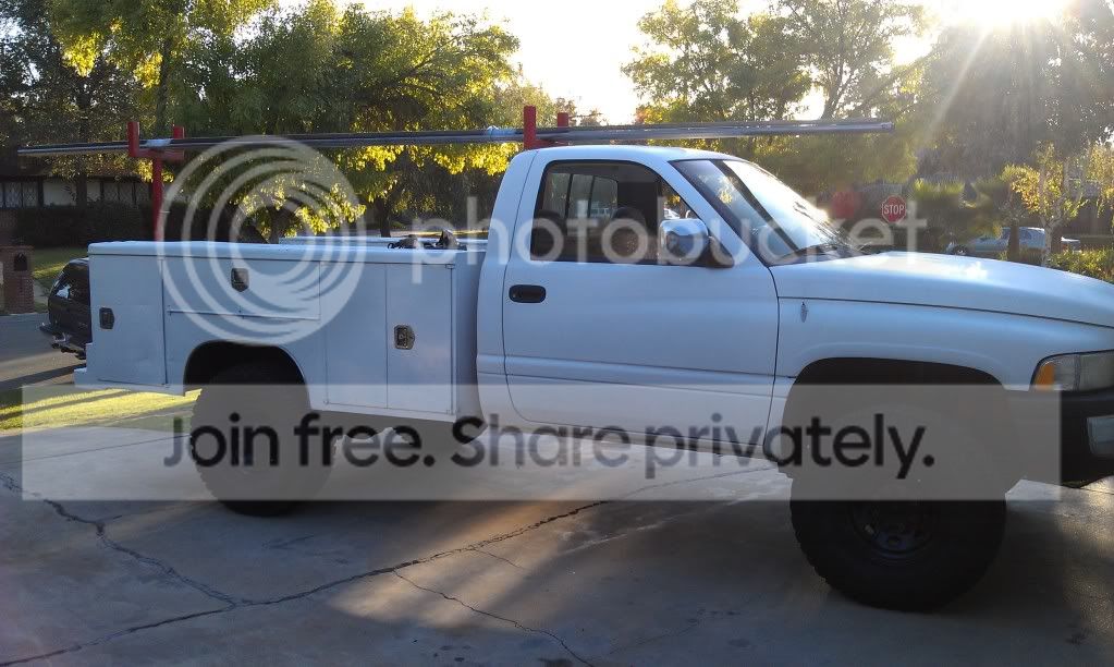

I used to do it like everyone else and strap them to the deck of my trailer but that got annoying to have to haul the trailer every time I wanted something in a full stick. I built a little hitch extension for the back and notched a spot out of the front of my service bed and welded in a piece of tube flush with the front of it that another upright slips down into.
It works well and when I'm not using it everything slips apart and can lay flat in the garage.
