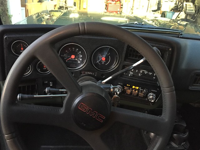

Keep it GM! I picked up a Delco GM2700 ETR shaft radio for $25 out of a Monte Carlo and sent it out to a radio repair shop in Texas to be rebuilt (cost like $75 for that). Its 4 channels from the factory, looks right at home in your dash, sound incredible and can be updated. I installed a wireless bluetooth receiver, attached to an FM Modulator that was installed in-line with the antenna connection. When its turned on, it cuts off the antenna completely and only feeds the radio with my Bluetooth audio, when switched off, the Antenna passed to the radio and i get excellent reception.
