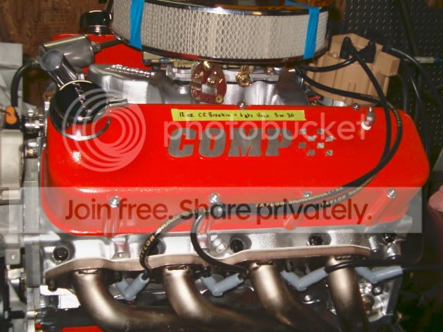

I have hooker pro comps on my big block and the # 7 is a biotch to get out....
I can only break it loose with a socket....and then it has to come out with my fingers...because if I back it out with the socket it gets trapped behind the header tube and then can't get the ratchet out.....:rolleyes:
