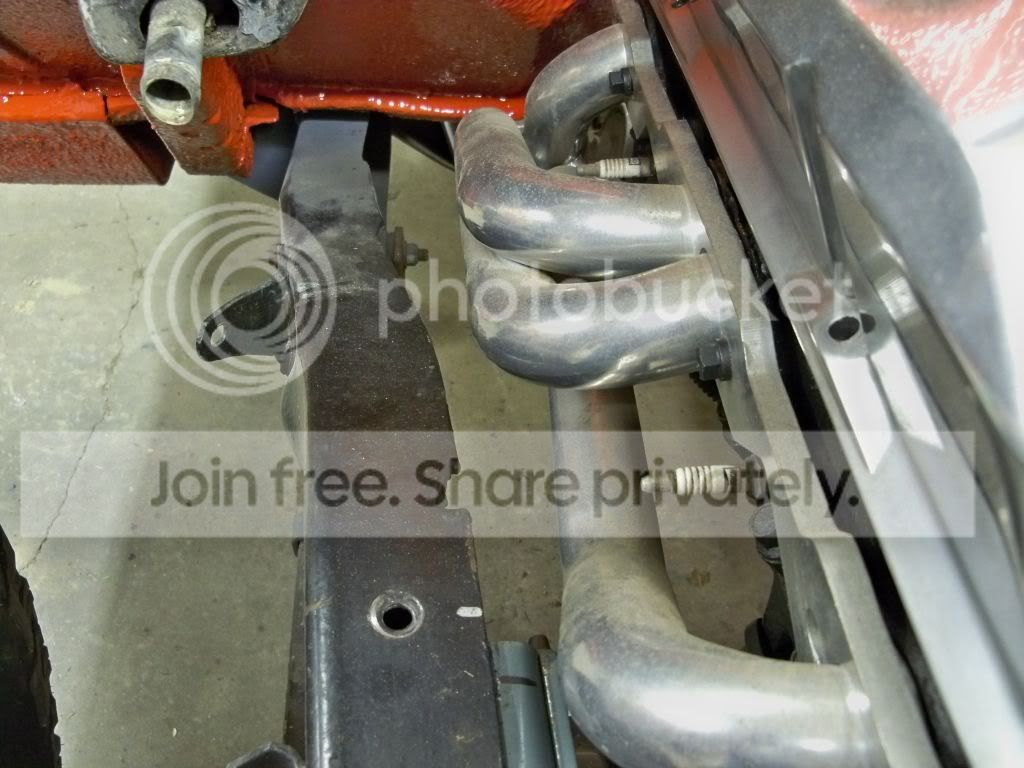

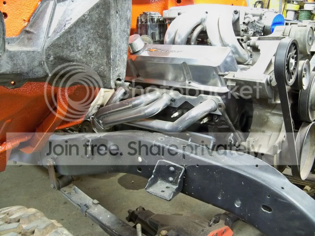

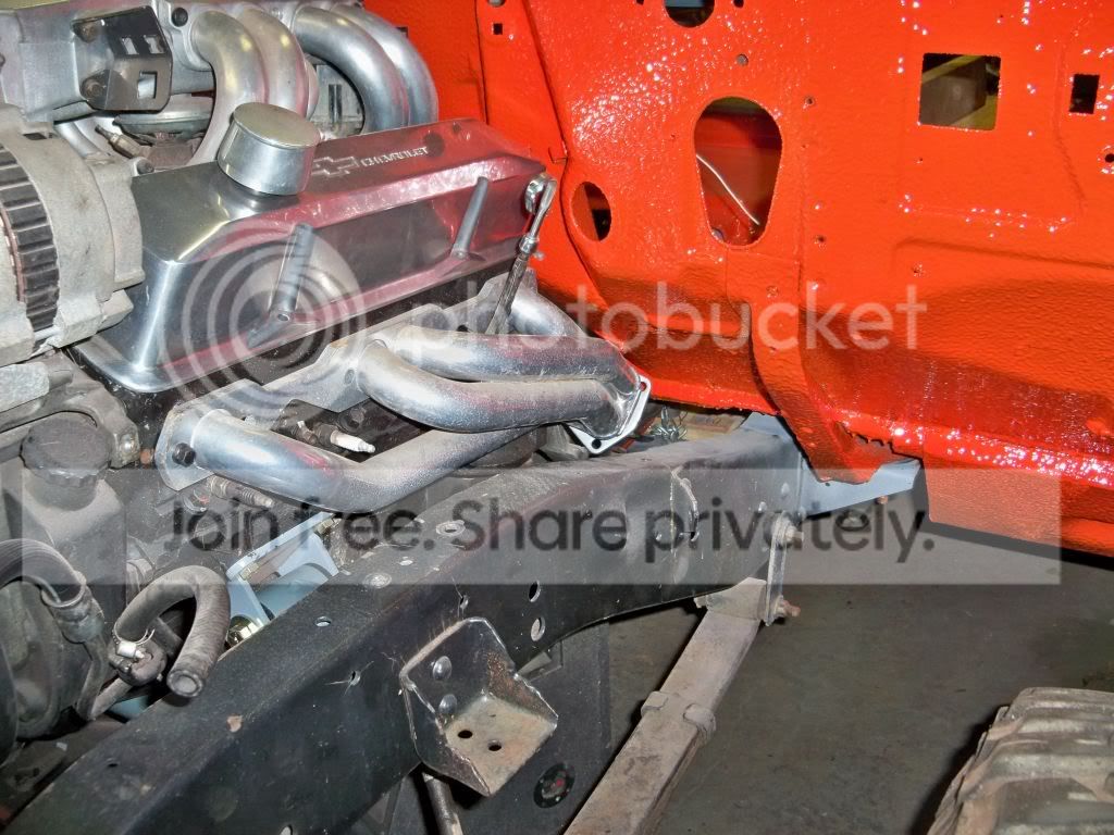

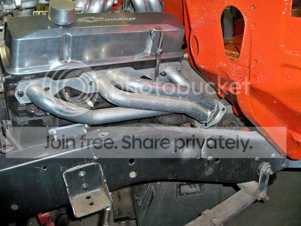

jgfsurfer-I will get a pic for you. There is no motor in it but the clutch linkage is all on the frame so you can compare it to yours and its location.

The linkage runs through the headers. You have to take the linkage apart to get the header in and out. Cylinder #5 tube runs straight back and then sweeps down and back to create a gap for the linkage. # 1 and #3 run below the linkage. They look like they did this just for the 4 speed linkage.
