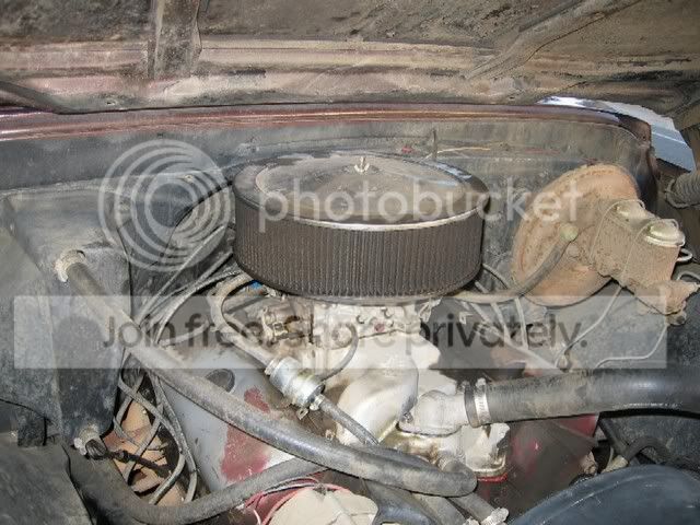

    you probably have plugged lines. if itsnot that. then you heater core is plugged and needs to be replaced, i dont know if you can clean it. my heater on my 67 with a big block works amazing, my engine runs at about 200 degrees and my lines come from my water pump and engine block. you can kinda see them here:
    [​IMG]
