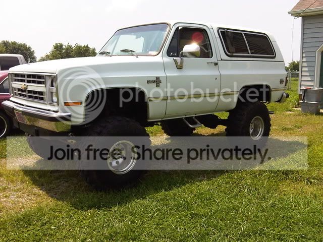

Where I started: Purchased in 2009 (second K5 I have owned) from a co-worker. 1987 K5, TBI 350 (stock), 700r4 tranny, and 10 bolts front and rear. Previous owner put on a RC 6" lift w/ standard blocks in the rear, 3" body lift and some 38.5 TSL Super Swampers.
I decided I didn't care for the 38.5x15x15 look so I dropped down the 37x12.5x17s and some Blazin Offroad Bumpers. Plus a move from TN to NC.
Learning a lot as I went, I still wasn't happy...10 bolts, blocks in the rear, body lift, etc. Sourced a 14ff and some 56" springs and did the shackle flip and got rid of the block and the body lift and while I was there, decided to throw on some Duplicolor bedliner on the outside. And a soft top from the Mrs. for my B-day.

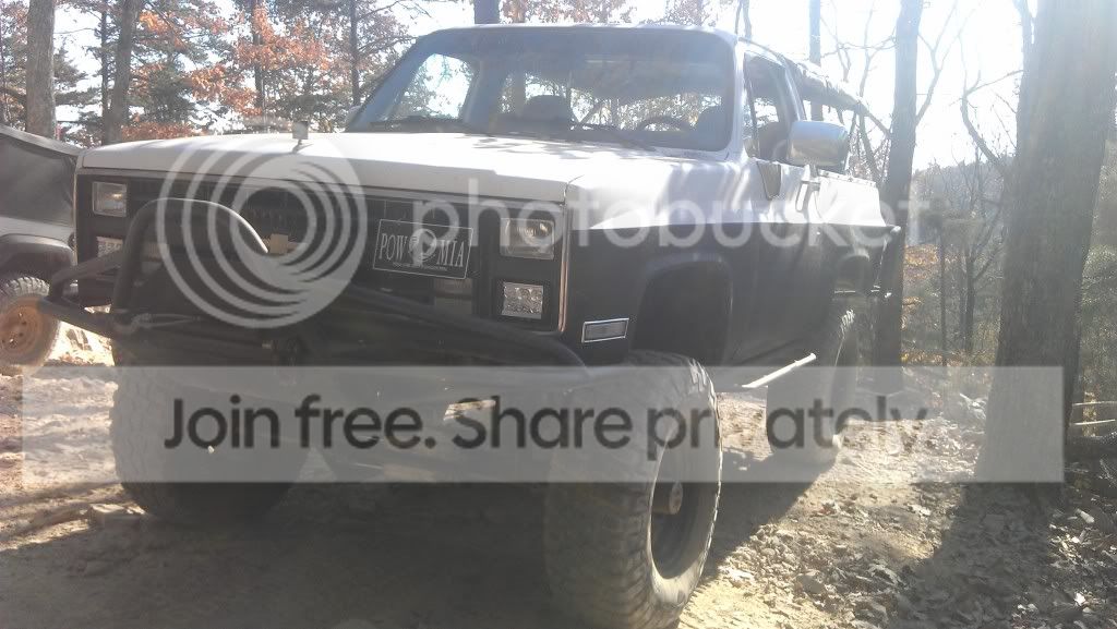

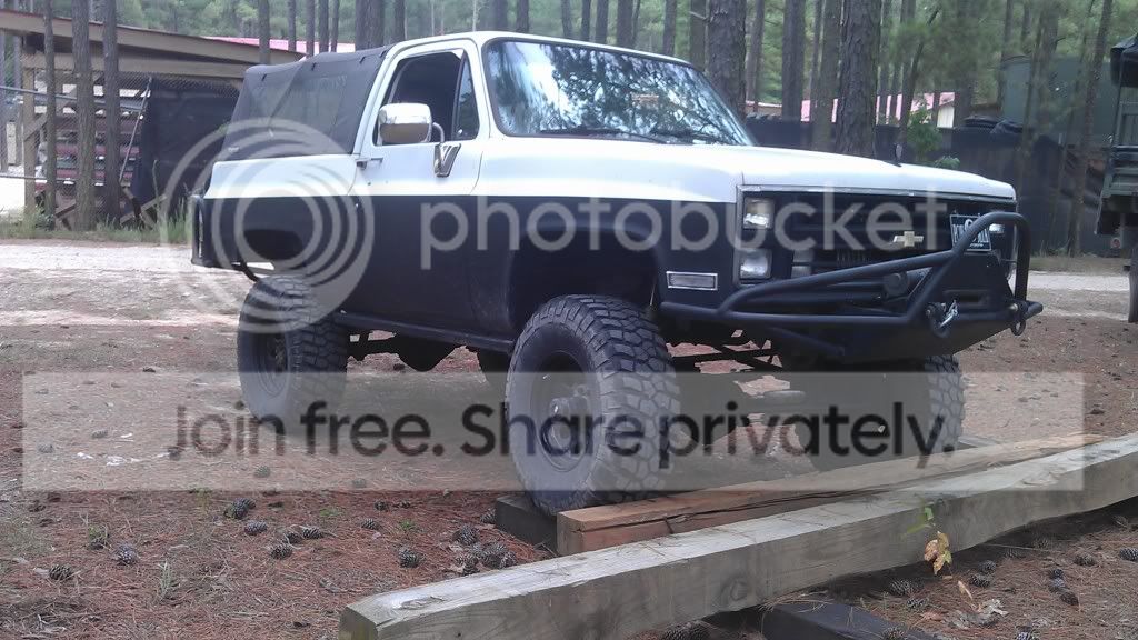

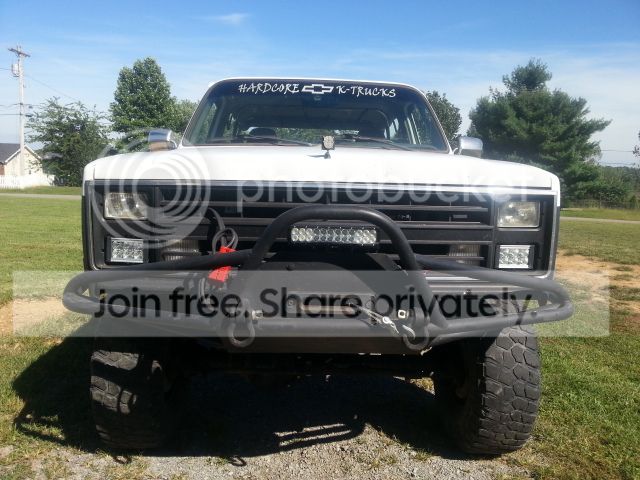

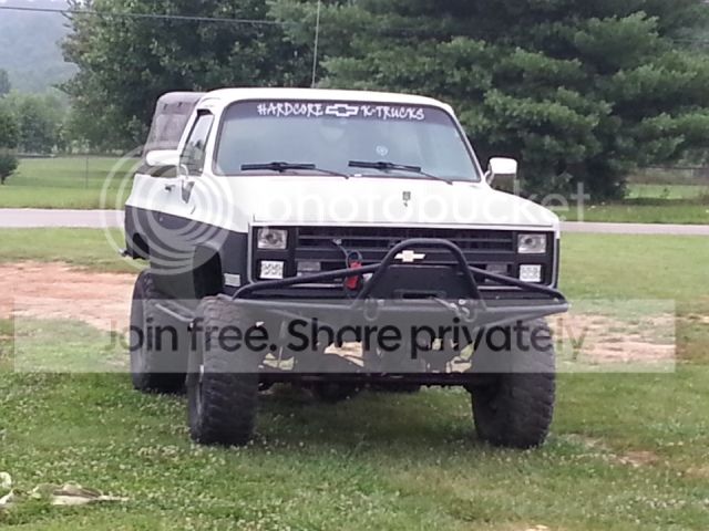

Where she sits currently.
Today, Im back in TN. She sits as follows.
Front End
Military Dana 60 with 4.56 gears, Spartan locker, 35 spline chromoly outers, Yukon Lock outs, ORD/Alcan 6" lift spring, spring pin moved forward 1", ORD HD shackles, Bilstein 5100 14" travel shocks, HID headlights, 4x6 LED high beams, 12" Sidetracked Offroad LED light bar, Warn 9000 winch.
Rear End
Military 14 bolt FF, 4.56 gears, Detroit Locker, 56" 1-ton rear springs, ORD Shackle flip reversed, DIY4X shackles, disc brake conversion.
Tires
Currently, 37x12.5x17 BF Goodrich KM2s on black steelies.
Motor
Stock 5.7, RV Morse bored TBI w/ fuel pressure regulator, matched fuel injectors, salad bowl, K&N filter, 140A Chevy Caprice alternator, Ford WIndstar dual fan assembly, BMW dual temperature switch, A/C delete, Optima battery (dual battery set up in the works). 1.5" hydraulic Ram, Ported 2wd steering box w/ DIY4X steering cap, Redneck extra fluid reservoir, Off Road Design (ORD) Cross-over steering. ORD weld in and bolt in steering brace, 4 wheel disc brake proportioning valve.
Transmission & Transfer Case
Built 700r4, NP208, Tom Woods DC driveshaft.
Body
Blazin Offroad front bumper, bedlinered lower half, EZ door removal pin mod, Softopper soft top, custom rear swing out tail gate, custom rear bumper.
Extras
2004 Silverado front seats, Tuffy Security center console, DIY4X Aluminum Dash, Autometer gauges, Summit Racing/Maradyne Marine heater, PO Hurculined interior, custom Hi-Lift jack mount, Dynamic EFI ECU.
Probably a few items Im forgetting. But here she is now.

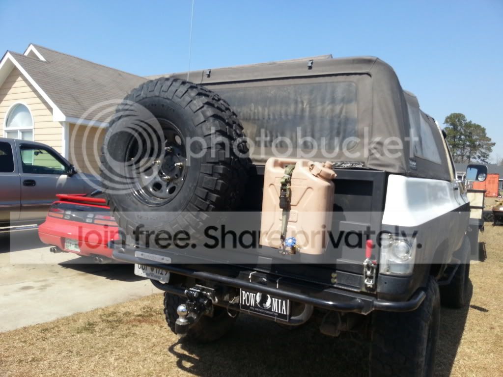

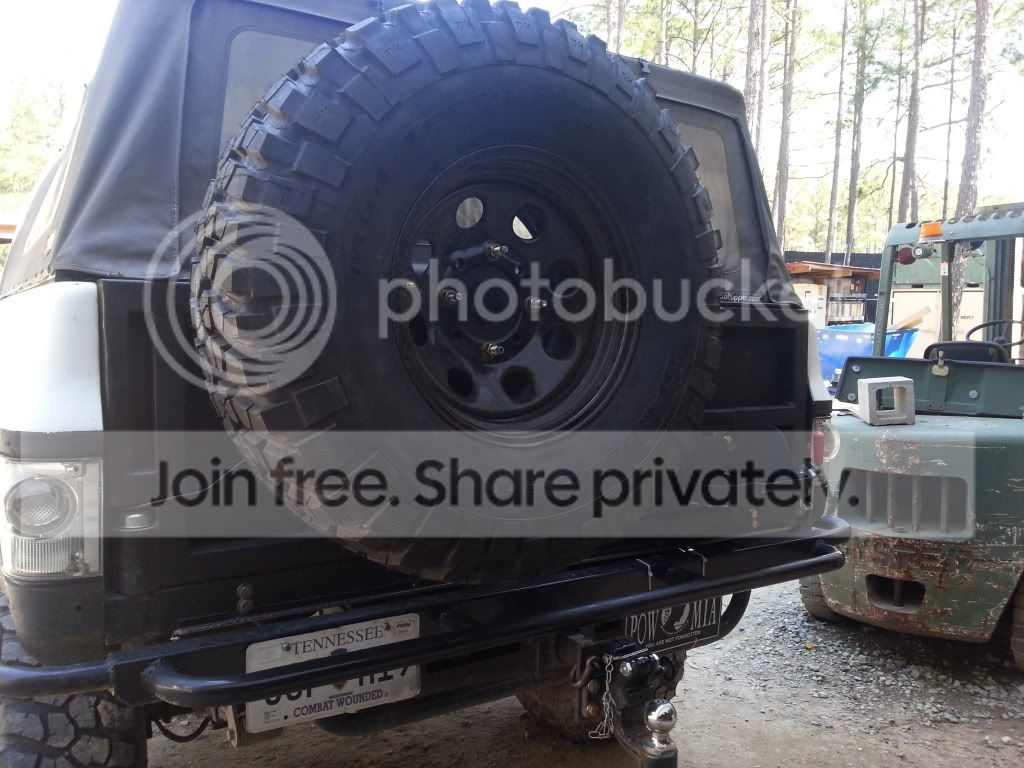

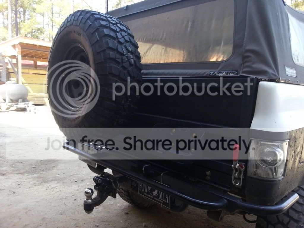

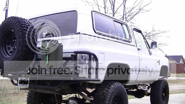

Good job on the rear bumper/swing out.
I wish I could take credit for that rear tire swing out in the picture above but that is the Blazin Offroad rear bumper I was mentioning. This is how her arse looks these days.

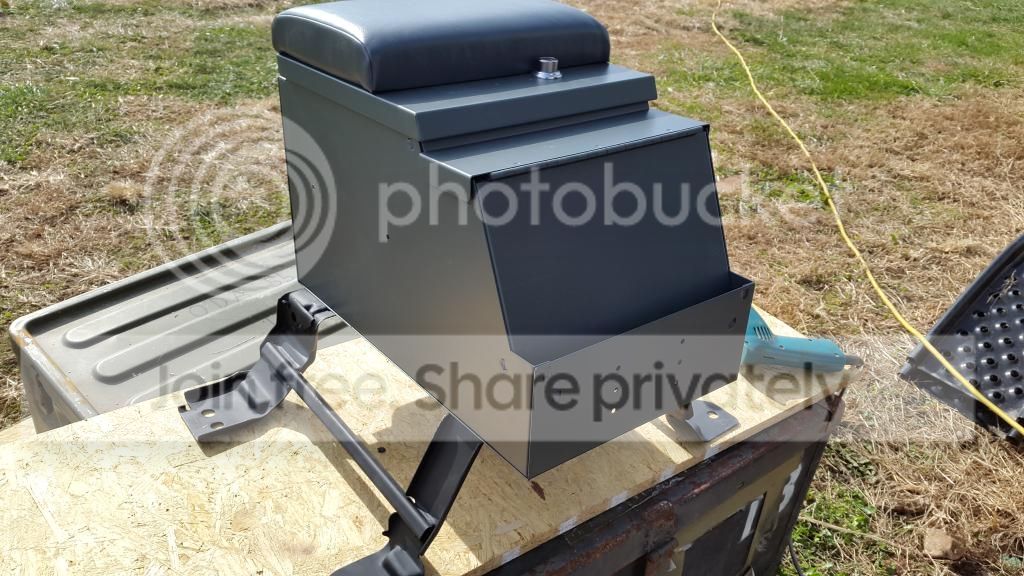

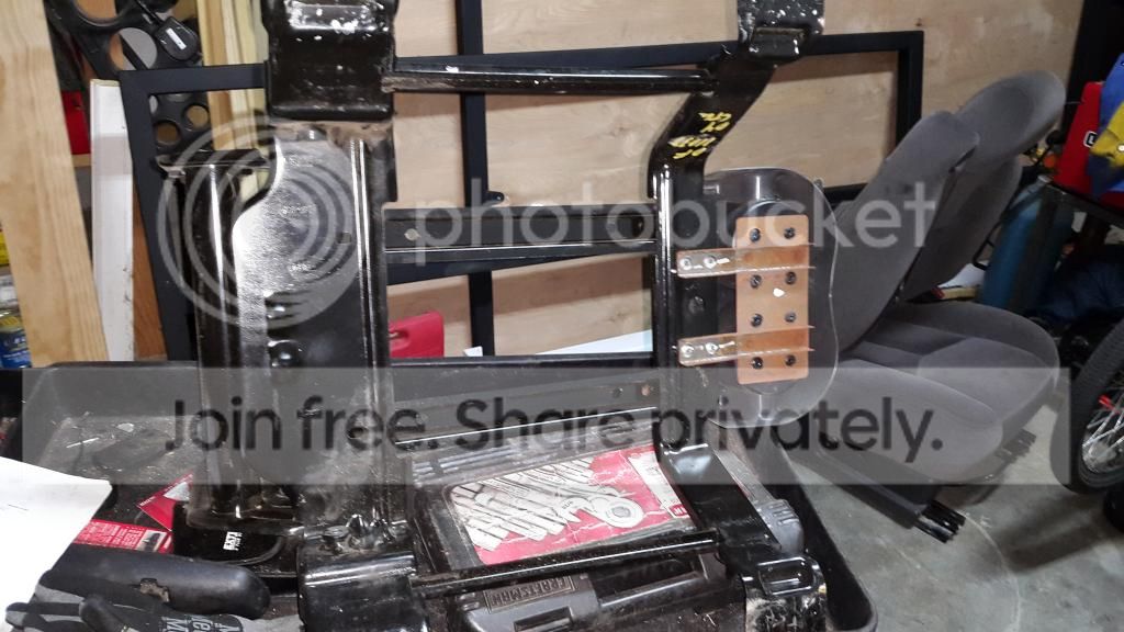

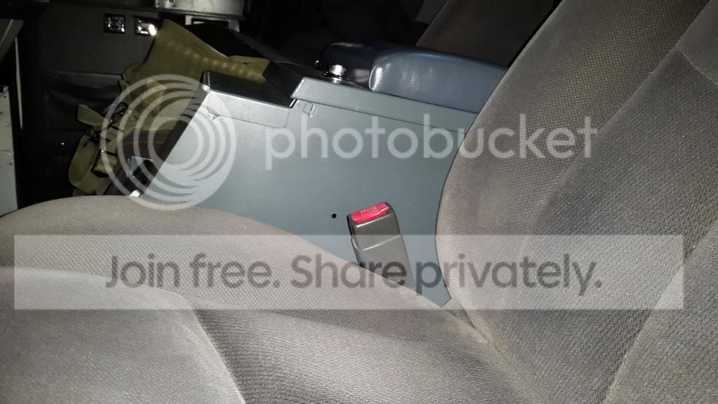

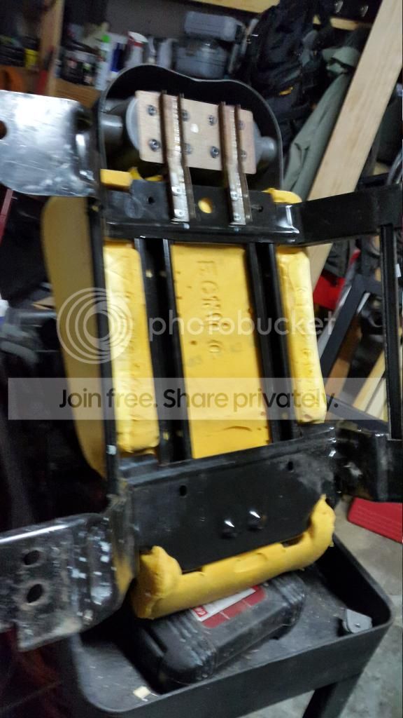

Last weekend I received a Tuffy Security center console. The Silverado jumper seat lid had broken at some point and instead of paying $100 for a new lid, I opted to spend a bit more and get something I can lock up.
I decided to use the frame from the jumper seat to mount it. I think it worked out great.
Sorry about the blurry pic.
