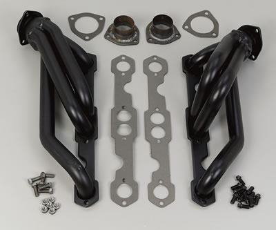

how good are mid-length headers, like the ones pictured below? You definitly will not have a problem with them hitting the sprring shackles.
Those are still shorties.
