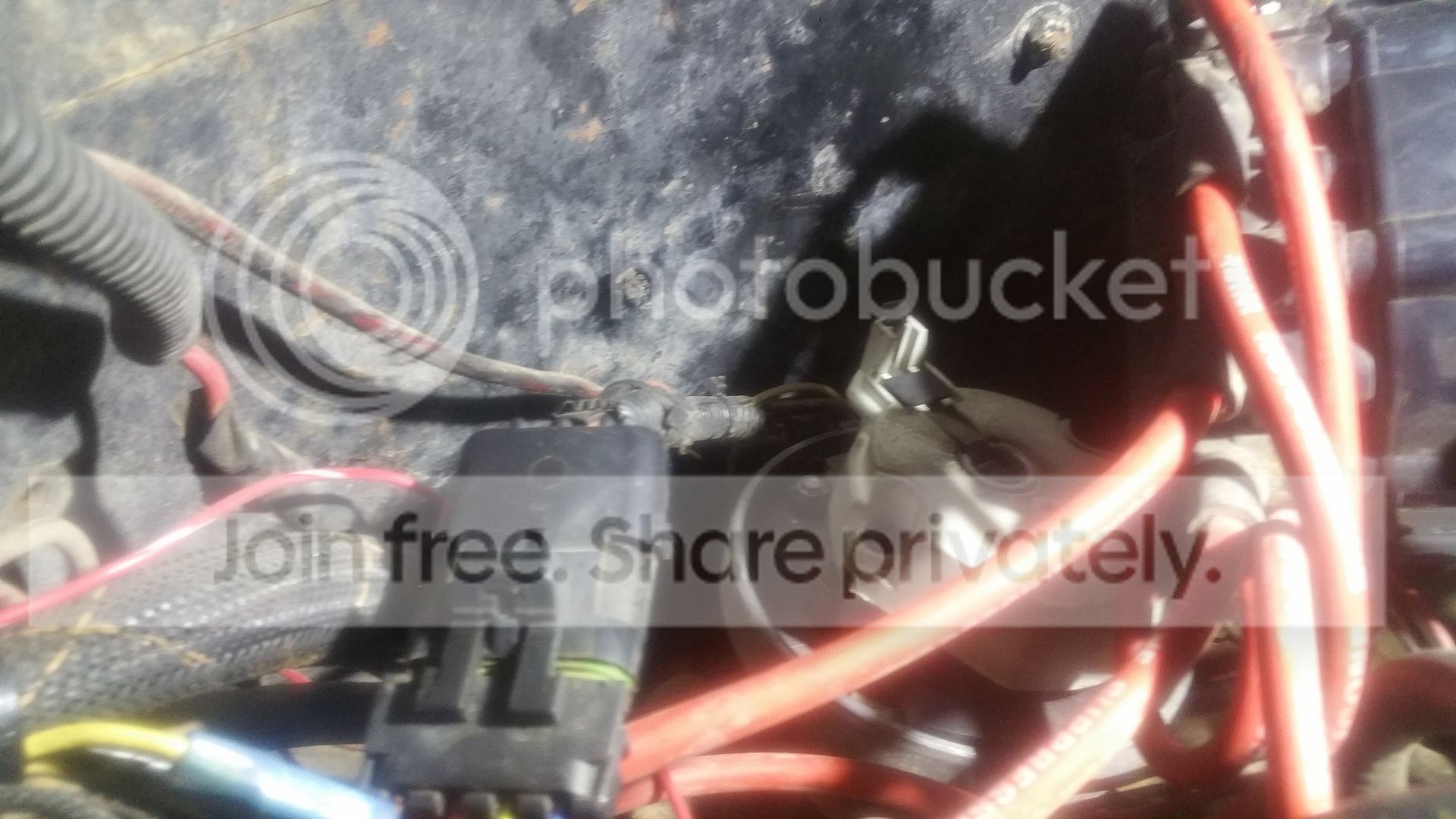

Hey guys, none of the parts places can help find what i need. When i installed my doubler the engine must of sat back and it broke the cap of my delco remy hei on the firewall. So i figured time to get a new msd hei and wires. The problem is the msd only has one set of wires going from the billet base to the cap. The delco remy has two sets of wires coming out of the base. One to the cap and one to my holley 4di projection. Does anybody know of a msd or a good hei that will work? Thanks in advance.
here's a pic of what im working with.

Did the old Delco HEI have a 4 pin module ?..or one for "EST" spark control with more pins ?..

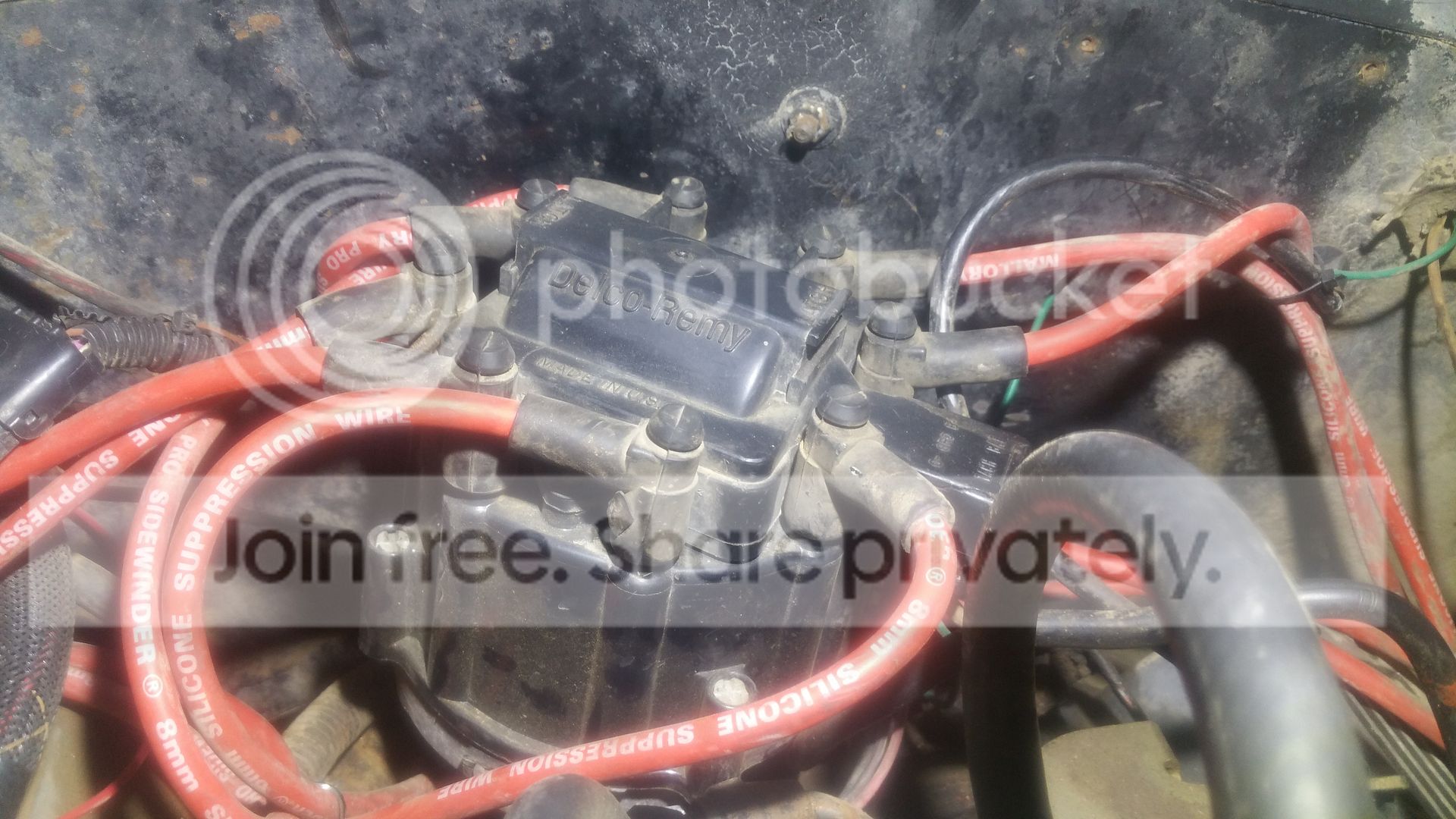

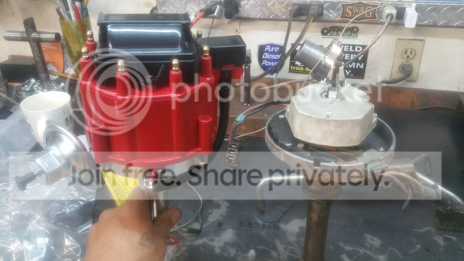

here's some more pics. the second one shows the plug to the holley projection. I think im just stuck getting a davis computer controlled hei.

Thanks for the offer diesel4me. Im actually coming from the diesel world and have 11 sec cummins. Probally the reason for all my distributer confusion lol. For future people that might run into this post. The holley 4di is a 4 pin connector and the replacement distributer i used was a davis unified ignition (dui) 12600rd.
