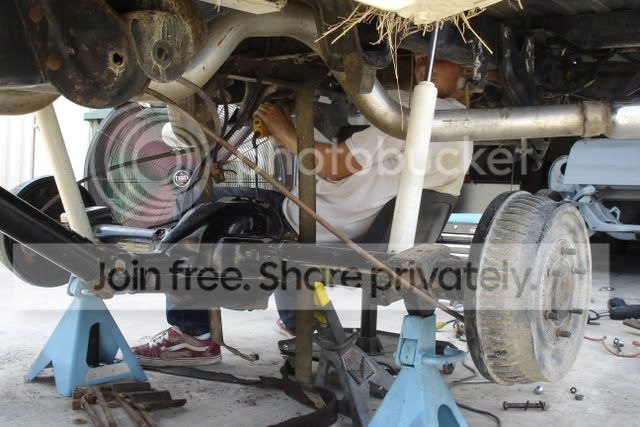

i think you guys had me fooled! this takes FOREVER!! i spent all day getting ready for the flip kit and boy was it hot. its 102 without the humidity factored in. i got the gas tank out and all the rivet heads ground off but HOW the hell do i get the brackets off!?!?! i gave them a good ol whackin with the BFH and the air hammer. i got one support bracket underneath one side off so far. the others are just so danged hard to get off.
its so nice workign under a lifted truck, i get to sit down when i do it! heres how far i got:
Hit it harder. you can't damage something you are going to throw away. when the brackets come off, grind the rest of the rivets flush with the frame and drive what is left out with a punch and hammer.
I always ground the heads off the inside of the frame. that way when you beat the bracket off it takes the entire rivet with it.
Do you have birds building a nest in your fender? I pulled a taillight once to find the fender almost full of grass. It was complete with little blue eggs.
Anyway, you might have more luck prying the brackets with a giant wrench than just beating them. If you are planning to junk the brackets, get the grinder back out and grind the rivets down further until you are almost through the bracket.
There are a few threads about getting frame rivets out. I had to use a punch and an 8lb hammer. The air hammer did nothing for me.
lol no thats from a recent 'froadin adventure. im gonna finish er up tomorrow. i aint about to grind em from the backside, im already sick of the few i did. i started thinking, eh its only 8. then i found the other 4 on the underside! :doah: then somehow i am missing my ratchet and an asst of wrenches. wtf man, ive just bought them in DEC. thanks for the ideas guys, and dustin id love to come to san marcos but for all summer this hasnt been a road truck over 30 mph. i seem to wait till the last minute like always. thanks for offerin and well meet up later.
thanks yall:bow:
Snowman1000 said:
Try a punch and a hammer on the rivet heads:dunno: drill them out?
x2
Try the punch and if it doesnt work then hit it harder. If it still doesnt work drill out some and keep trying untill youve taken off enough material for them to come out
