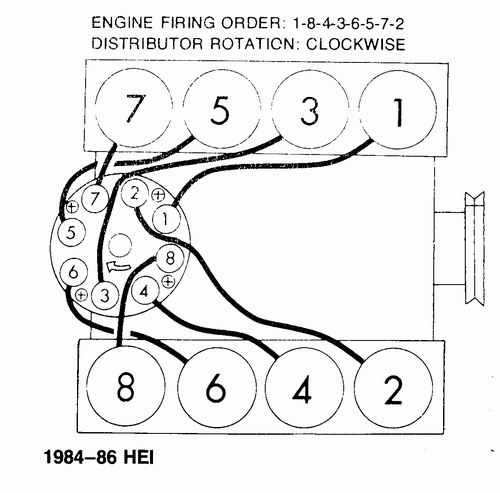

im thinking its the timing because we started it up on a stand b4 we droped it in. does any1 know how to find the firing order numbers on a HEI distributer? we took the cap off and i think we messed up the position. any ideas guys?
http://www.joby.se/corvette/misc/firing_order.gif If the pic don't work. It says 84-86...but it will be the sama as your's.
