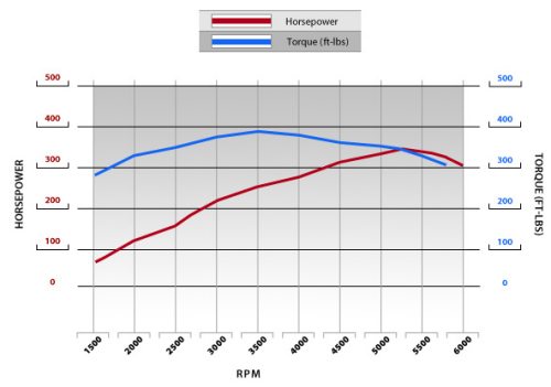

Here's a built 350 next to a stock 8.1L. They make "the same power", but other than a $5k supercharger setup, no SBC can compare down low. Basically whatever the SBC/LS can do, the 8.1L does in the next higher gear. Torque and power are similar to early D-Max.
