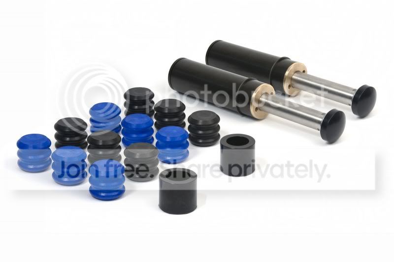

Currently I have the factory bumps spaced down just so I didn't ruin my shocks but after just a couple trips I've trashed them (I guess no surprise there :doah:) so I've been eyeballing the Daystar bumps...

On a side note any of you guys have experience with these Daystar bumps? I kind of like the idea of something somewhat tunable but I'm not sure if they're worth the price. I was looking at some FOA hydro bumps last night that were $150 a piece and they came with the mounting cans. These Daystars are $109 a piece and they don't come with cans (about $20 extra) so I'm now wondering if I'd be better off going with the FOA's.
Maybe overkill for a leaf sprung rig but it'll give me something to grow into. :)
Go with the FOA's. The rubber bumps do not last as long and the shaft is not constantly lubed.
Quality bumps on any suspension is a great upgrade. I have done a couple on leaf trucks. The owners loved them. No more hard hits. Fewer parts breaking because you do not have the hard impact on parts.
Even added a set of 2" to a stock truck. Dude won them. Ride was much better in the desert and he could go through stuff he had to crawl before.

i've got no personal hands on with the pro fender,
but i did ahve a chance to fondle the daystars for a bit at the 4wp show this year. def a neat concept, for the money i dont think its worth it tho. at that point just get some stock bumps from the JY and make it work. for a little bit more i'd go with the nicer set. it was cool that you could trade the cells to adjust the stiffness on the daystars tho.

I've been checking those out since you posted earlier and they seem like another good option. The side by side comparison here is helpful...
