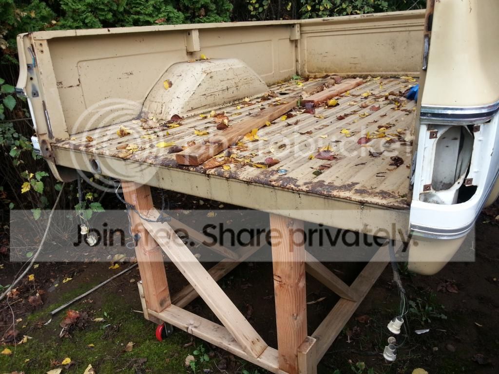

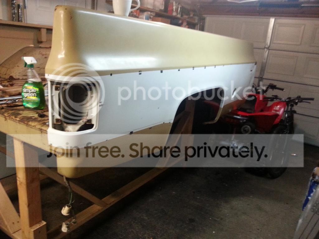

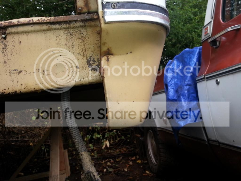

I have this bed that im going to paint for my 78. Im going with the original russet brown and white that came on my 78. I'm making this thread to get some guidance. My hope is that it will turn into the "Ryoken's guide to the average man's driver quality but still nice paint job" thread.
To begin, Here is the bed.

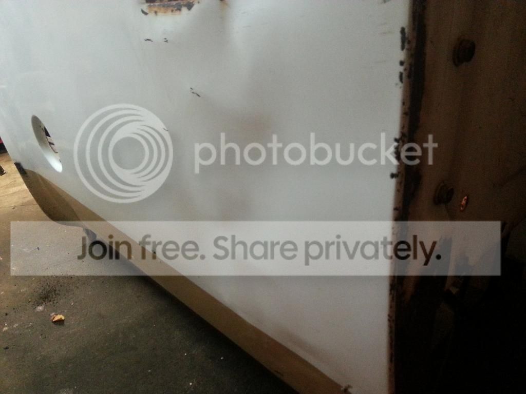

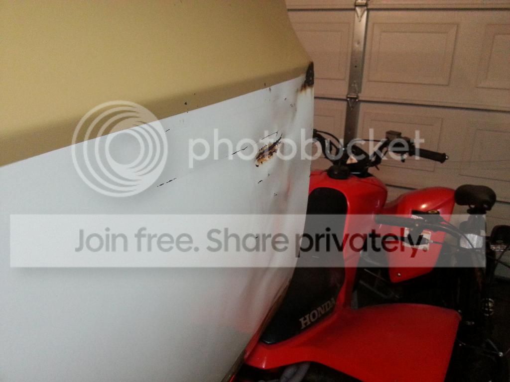

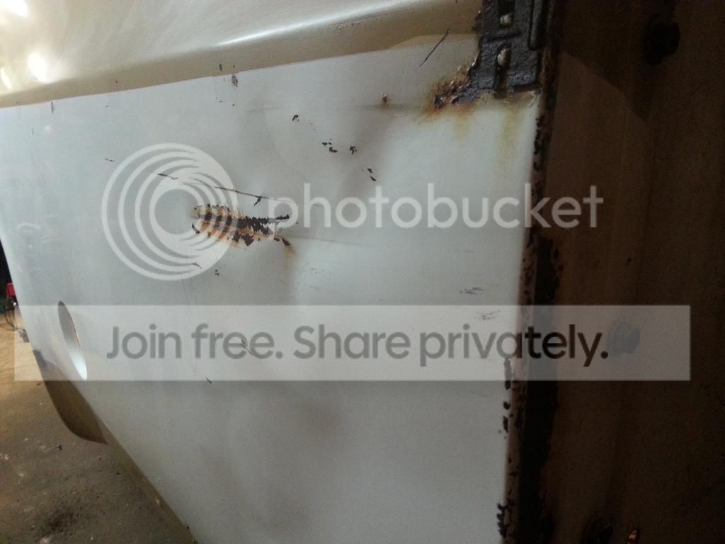

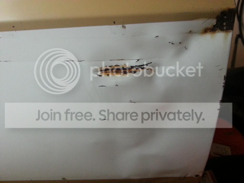

So where i intend to start is by fixing this dent on the bed side. This truck will be a driver and will still get used and abused a good bit so im not concerned about having to lay on a little bondo. From my research, (and as advertised on the bondo brand web site) bondo can be applied up to a quarter inch thick. I'm not going to be willing to do that. But i think i could sleep well at night if i had a max depth of 1/8". So what i need advice on out of the gate is, what approach would be best to fix this rippled up dent area?
A stud welder gun and slide hammer works wonders,without having to poke holes for a dent puller...if you can access the back side a large dolly and body hammers work too,but they require some skill...
I'll have to check our the back side. It might be possible to snake my hand up there to hold the dolly. I'm not terribly concerned about making it perfect. I just want it perfectly bondoable! So if I can just minimize the waves with some metal work, and come back and make it perfect with body filler, I'm happy with that.
I agree with pulling out as much as you can, and for God's sake when you use filler use the good stuff...it's well worth the minimal extra cost.
Im happy to pay for good filler! What do you consider the good stuff as opposed to the bad stuff?
The dolly would need to go on the outside,and the dent hammered out from the inside...which may not be possible if its double walled or you cant get at it from behind...you may be able to pry the dented area out with a hunk of wood or 2x4 used as a lever..body work is tricky,I am not very good at removing dents..
I leave them in for "character"...
Cheif Brody is right about bondo too,I only use fiberglass bondo that is water proof,not the crappy talc based stuff that sucks water in like a sponge and makes it rust under the bondo,or pops it off when it freezes..
Interesting. Im thinking a stud gun and a stud lever to get it mostly decent and then fill the remaining imperfections with filler. How does that sound? I would like to know what fillers i should be looking at if regular old bondo is not the best for the job.
use all metal over bondo for a filler. Yes the name of it is allmetal. Don't put on thick and have a cheese grater handy to block it down before it get's fully hard or it will suck to do.
plenty of dollying is done from the inside... as a matter of fact, it's a more common technique... I would strongly suggest at least getting some spotblasting going to clean up the rust...
there are cheap alternatives to a stud welder if you have a mig.. invest in a cheap hammer/dolley set, make sure it has a shrinking hammer... a map or oxy torch is helpful for shrinking/dent removal too.. i'll post more when I get some time.. nighty night... :D

I will be picking up a HF spot blaster. The research i have done on them leads me to believe that it will work perfect for what im doing and be easy to use. I do have a mig welder. Its a pretty decent unit but im running it on flux core wire. Would one of the standard HF hammer/dolly sets be ok? Like this one?
