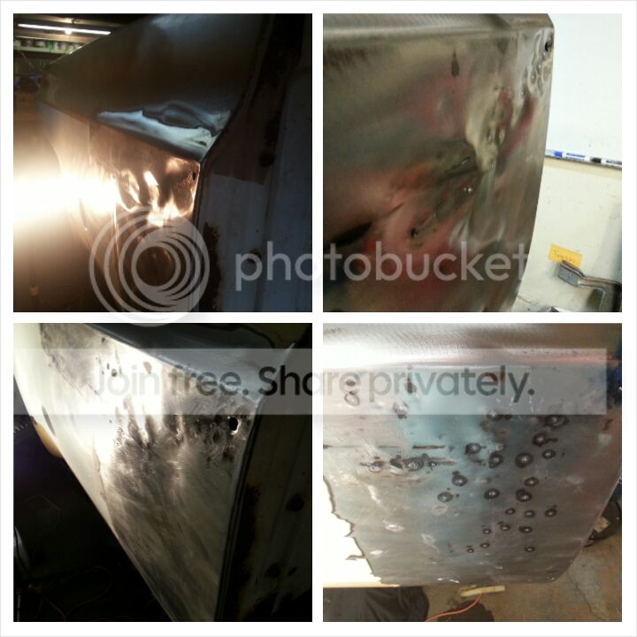

So over the whole 4 day weekend I got about 2 hours in on the bed. I think that area is pretty well ready for a sand and filler. I still have a few other dings and such that will also require filler. Should I work those areas too and fill everything at once? Or do each spot at a time?
it's always the most efficient to do all of one thing at a time.... do all your metal work, prep it all, fill it all, fair it all, featheredge it all, prime, glaze, wetsand, reprime, prep, paint, dance...

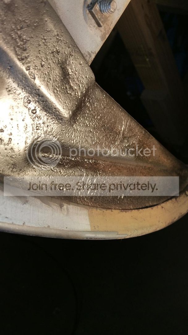

So I'm just about ready to apply some filler. I'll get the duraglass and rage gold. So to apply the duraglass, I should sand the area with yonderish of 36 grit on the bare metal. Correct? And then if I need to apply rage gold in an area that spans from the duraglass to bare metal, what grit should I be sending that with? Finally, once I get the entire panel ready to prime, what grit should I use for the first primer layer, and what primer should I be using? In my research I have read that it's best to epoxy prime. Is that true?
GRIND whatever areas need fill with 24 to 36 grit... all of it, larger than the dented area...
fill everything with the glass.. rough that out with 36... than put a skim coat of the rage over all the glass and out a few inches... make sure you go back in after ripping the glass with 36 and nip any low/shiney areas with a grinder before putting the rage over it.. shiney = poor adhesion
rip that with 36 and finish off with 80... DA sand all surround metal with 80 to 150ish...
a lot of guys like epoxy.. I don't.. it sands kinda sh*tty.. painting a bridge or frame, than it's good imo.. you can also epoxy everything than overcoat with urethane for good sanding... that's what you'll see a lot of guys do.. get's expensive and time consuming imo..
I prefer zincing the raw steel, not the filler.. than overcoating everything with a urethane primer like nason 2k, etc..
than squeegee glazing putty on the mud areas.. wetsand with 220 to 240.. reprime.. wetsand.. paint...
